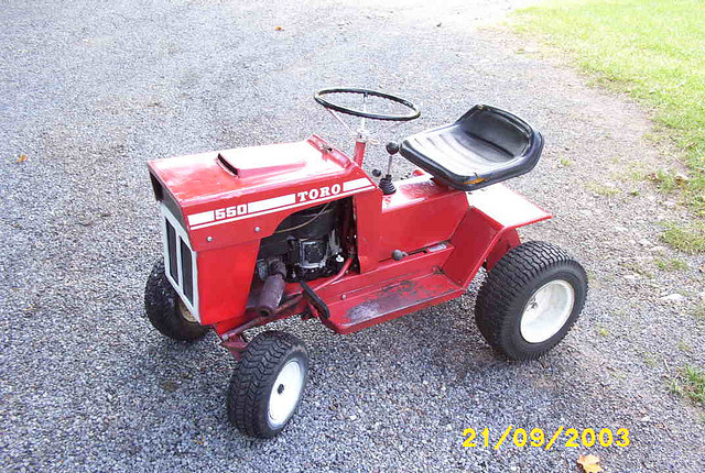

can i see some pictures of that toro you posted on the first page? i think we had one of those a long time ago and i still have the tranny out of it
i assume its a 3 speed tranny with a chain drive to the rear axle?

No problem - at the moment its sitting on a table in the back of the shed , i found some original size tires i plan on putting on it , along with making it mow again ( ocassionally ) - ill probably straighten some of the metal and clean it up a bit, i wont full on restore it tho. I plan on keeping that one- it kick started my tractor tinkering many many years ago...
In this pic- the original rear wheels are on the front - the back wheels came off another tractor - was back in the day i took it thru the swamp behind the house - mean lil mud machine. Yeah its the original 5HP briggs with electric start and a 3 speed manual with chain drive to differential axle - i did replace the worn out factory axle bushings with pillow blocks - other then the wheel change in the pic- its all original. I do plan on rerouting the exhaust - it starts burning my sneeker when i push the clutch ( has separate brake n clutch).

PostSubject: Re: Agway offroader project   Mon May 30, 2011 9:41 pm
thats the exact machine we had years ago, my brother and i had good plans for it just not enough time when we got it there was a small piece of the fiberglass hood missing right at the scoop and that was all that was wrong body wise and the motor was shot, we had the bylaw guy after us tho so it was stripped and scrapped
