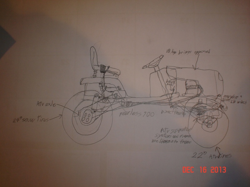

PostSubject: 1998 murray pulling/lifted project   1998 murray pulling/lifted project Icon_minitimeDecember 17th 2013, 11:46 am
something I drew
1998 murray pulling/lifted project Projec54

PostSubject: Re: 1998 murray pulling/lifted project   1998 murray pulling/lifted project Icon_minitimeDecember 17th 2013, 12:04 pm
Nice plan

PostSubject: Re: 1998 murray pulling/lifted project   1998 murray pulling/lifted project Icon_minitimeDecember 17th 2013, 1:45 pm
on your sketch you need to put the output for the 700 close to the swing arm pivot. MHO

PostSubject: Re: 1998 murray pulling/lifted project   1998 murray pulling/lifted project Icon_minitimeDecember 17th 2013, 2:06 pm
Yeah he does, but its not your MHO it's a fact  Very Happy
or in the same line as the arm will pivot.

PostSubject: 1998 murray pulling/lifted project   1998 murray pulling/lifted project Icon_minitimeDecember 17th 2013, 2:51 pm
I know, I just drew it so you could see everything.

PostSubject: Re: 1998 murray pulling/lifted project   1998 murray pulling/lifted project Icon_minitimeDecember 17th 2013, 3:54 pm
ok, I just wanted to point that out. Smile
