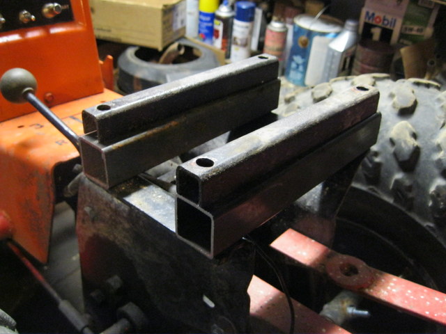

This raises everything up 1-1/4" Found some square tubing laying around finally.
Simplicity System 5010 Off Road Adventure Thread - Page 4 Img_3815
Stock risers on top of the box tubing. Just have to get some extra long bolts and hook everything back together, then give it a test run. Maybe the carb will be fouled up by this time, guess we'll see.
Simplicity System 5010 Off Road Adventure Thread - Page 4 Img_3816

Pretty cool solution. I wonder how shifting will be effected. Seems that reaching down between my legs and even further may be a PITA. It already is. I'm thinking about extending the shifter upwards so I'm not bent over all the time trying to reach the shifter.
Points : 6557
Simplicity System 5010 Off Road Adventure Thread - Page 4 Empty
PostSubject: Re: Simplicity System 5010 Off Road Adventure Thread   Simplicity System 5010 Off Road Adventure Thread - Page 4 Icon_minitimeJanuary 2nd 2015, 9:43 pm
It's not too bad. I got it all bolted together and I think you barely notice a difference sitting on it. I stacked some giant washers on the spindles to space the new wheels out a bit and put the old collars back on. Should be good to go again. I had to pull the float bowl off and do a harf arsed cleaning job. Got all gelled up. Didn't think it was sitting that long but I guess fuel isn't too good these days. Got it running again anyway, but I didn't give the new tires a test yet.
