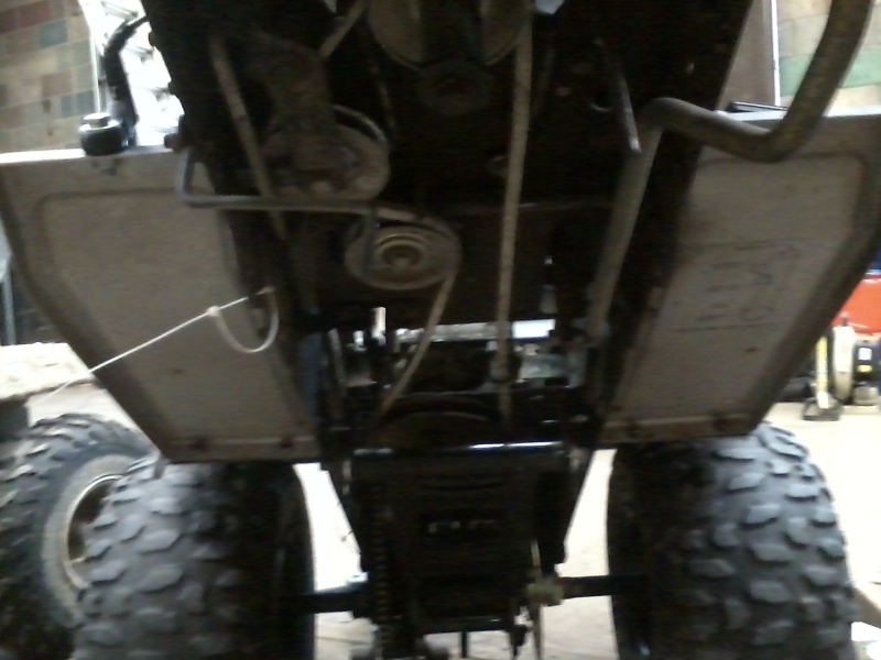

The other day I was looking at the Oppy and thinking. "Could/should I supercharge it."  Now I am looking for ideas on what to do (hopefully MowBandit can help me?).
Also first drive should be on Monday! I got the rear put together (except some fine tuning), so it's up for a quick test before I move on to the front!
pictures as promised...
LMM's Rally Mower! - Page 2 <a href=LMM's Rally Mower! - Page 2 1310" />LMM's Rally Mower! - Page 2 <a href=LMM's Rally Mower! - Page 2 1410" />LMM's Rally Mower! - Page 2 <a href=LMM's Rally Mower! - Page 2 1510" />LMM's Rally Mower! - Page 2 <a href=LMM's Rally Mower! - Page 2 1610" />LMM's Rally Mower! - Page 2 <a href=LMM's Rally Mower! - Page 2 1710" />LMM's Rally Mower! - Page 2 <a href=LMM's Rally Mower! - Page 2 1910" />
Throw me some input guys!!
I see a potential design flaw here with the chain tightener
I would not have it on the top because it will pull from the top making tension, I would have it on the bottom, the side Without tension.

Yeah Ariens I noticed that and moved the spring to a different hole.
TD: The tensioner is a clutch linkage from a simplicity lawn tractor.

tensioner should be on the slack side... as soon as the torque is transferred to the chain, the tensioner will be pulled down BEFORE the actin hits the sprocket. The set up looks great, and may even work that way, if you tighten the chain. But any mechanic will tell you the same thing.. the tensioner goes on the slack side of the sprocket/pulley

Ariens YT11 wrote:
Yeah thats true, It will make the tensioner work like all the time in OVERDRIVE in that setting.
So you need to redo it  Very Happy  But i liked the arm you chose.

I suspect your tensioner design has something to do with the angle iron running in between the chain?
Doesn't the ATV axle have an adjustment for the chain tension? Most of them do; loosen two pinch bolts and the carrier rotates off-center. You could use that, along with a chain guide. You could probably make a guide like they do on hill climb bikes. It's sometimes called a pie plate. It is two plates that mount on the sides of the sprocket. Some ideas to think about.

Easy fix, Just use a lower bolt hole to drop it, then let the tensioner wheel grab underneath the bottom running chain.
Easier said then done.  I tried moving it down today but the rest of the tensioner would hit the upper chain.  I think what I'm going to do it mount a stationary pulley like the four-wheelers do then as the swing-arm moves the tension moves a little.  I also thought about having something mount to the swing-arm itself and it be completely separate from the frame. Still thinking on a better way to do it though.
Give me ideas guys I need it!

Here's kinda what we were talkin about.
Move the bolt to a forward location,
Flip the assembly so the idler pushes the chain up toward the sprocket
attach spring to the upper part of the L as shown in the rough diagram, bottom right
This should keep everything tucked up outta the way, and put tension on the correct side of the sprocket

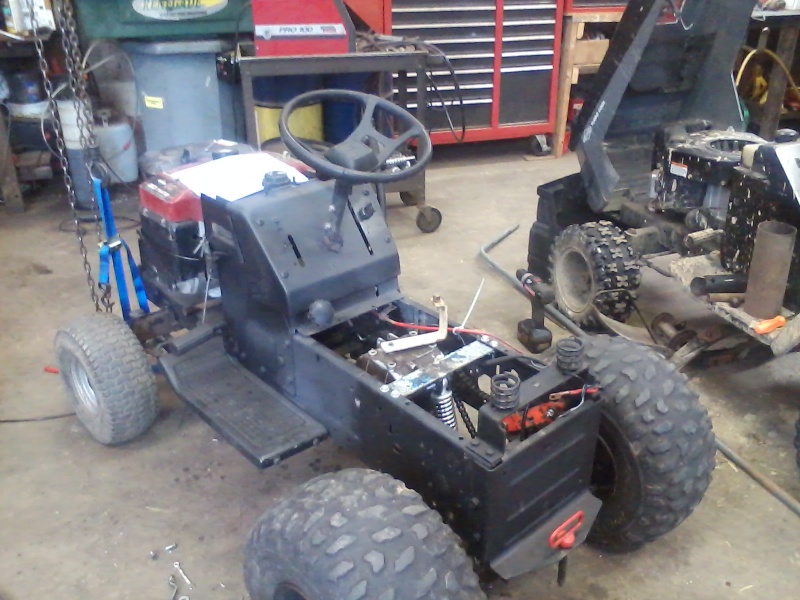

Not the best actually.... Why? you may ask?
FIRST: The gearbox is WAAYY too far back towards the rear-end.
SECOND: The suspension is WAAYY too weak.
THIRD: I don't know yet (but I'll find something)!!
(FIRST: The gearbox is WAAYY too far back towards the rear-end.)
(SECOND: The suspension is WAAYY too weak.)
This is why the rear end was pulling up thus bottoming out the suspension completely..
I will get to work on this better when I have a free weekend.
I have recently locked the suspension solid with a 1/4'' bar. Then my chain tensioner failed.  So I need to rethink my whole rear-end then cut it out and rework the whole thing!  So maybe not as many updates for a little while?
Sorta ticked about it...
