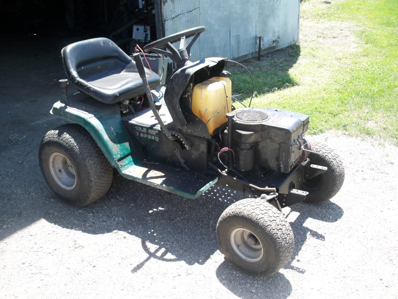

Well last summer my grandpa gave me a mower to screw around with. So i decided to turn it into a mud mower so far all i have done is got a hood for it and put on chains and it does pretty good.
What i want to do:
1) Lock transmission
2) Bigger front tires
3) nobbier rear tires
4) 1 to 1 gear ratio
So if you could help me out that would be nice

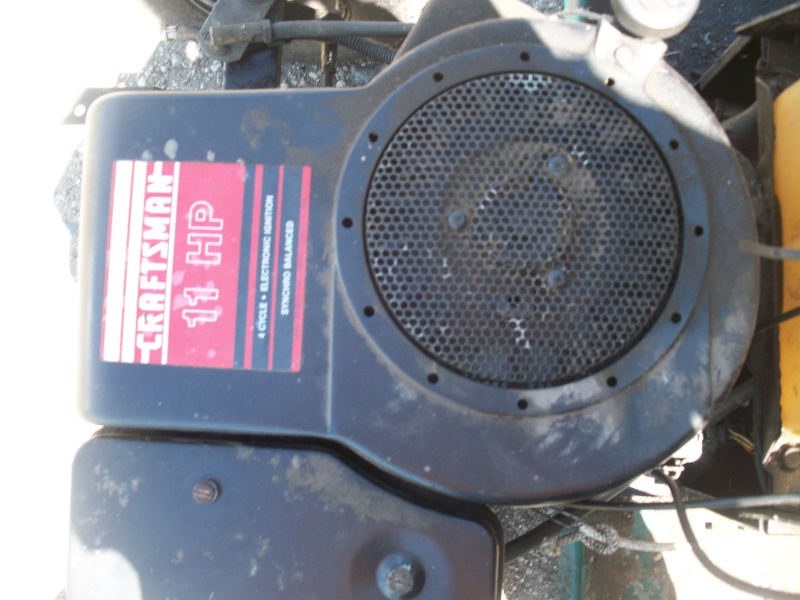

11hp craftsmen looking for a twin
Green Monster Biuld Go-kar11
But yah if any body could help with some pics on locking the trans i would greatly appretiate it.
