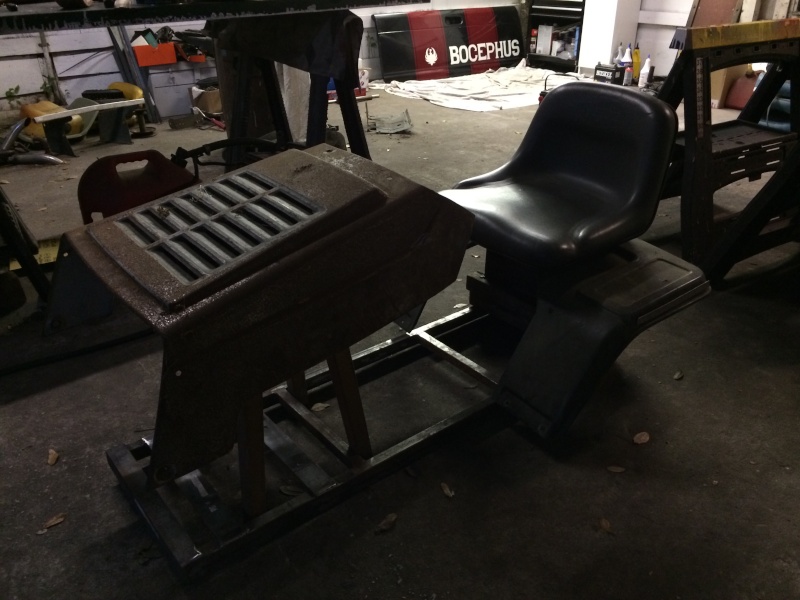

Starting a new topic because this is going to be all custom built. Custom frame, dash, seat, console.... Has the 20hp intek vtwin and I'm looking for a 820. Custom Mud Mower Image62

nice! good to see someone braver than me!

Got the fenders/floorboard mounted and console dash most likely will use. Mtd hood still fits nice just have to make a custom front nose peice for it. Custom Mud Mower Image74

man thats cool. frame looks like total beef.

Ya it does! Hell of a good start on it  cheers

Yea it's strong lol 1in box steel down full length with angle welded on the bottom of that to keep up and down force from bending but I don't think it would have anyways.

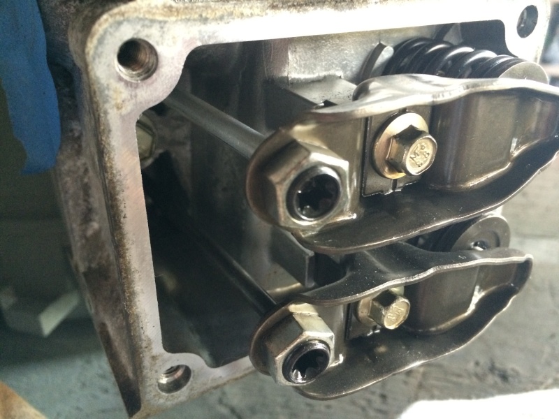

Pulled the valve covers off and saw aluminum pushrods on I take side lol is that normal?Custom Mud Mower Image10

Yes. The al. pushrod on the intake is normal for an OHV.
