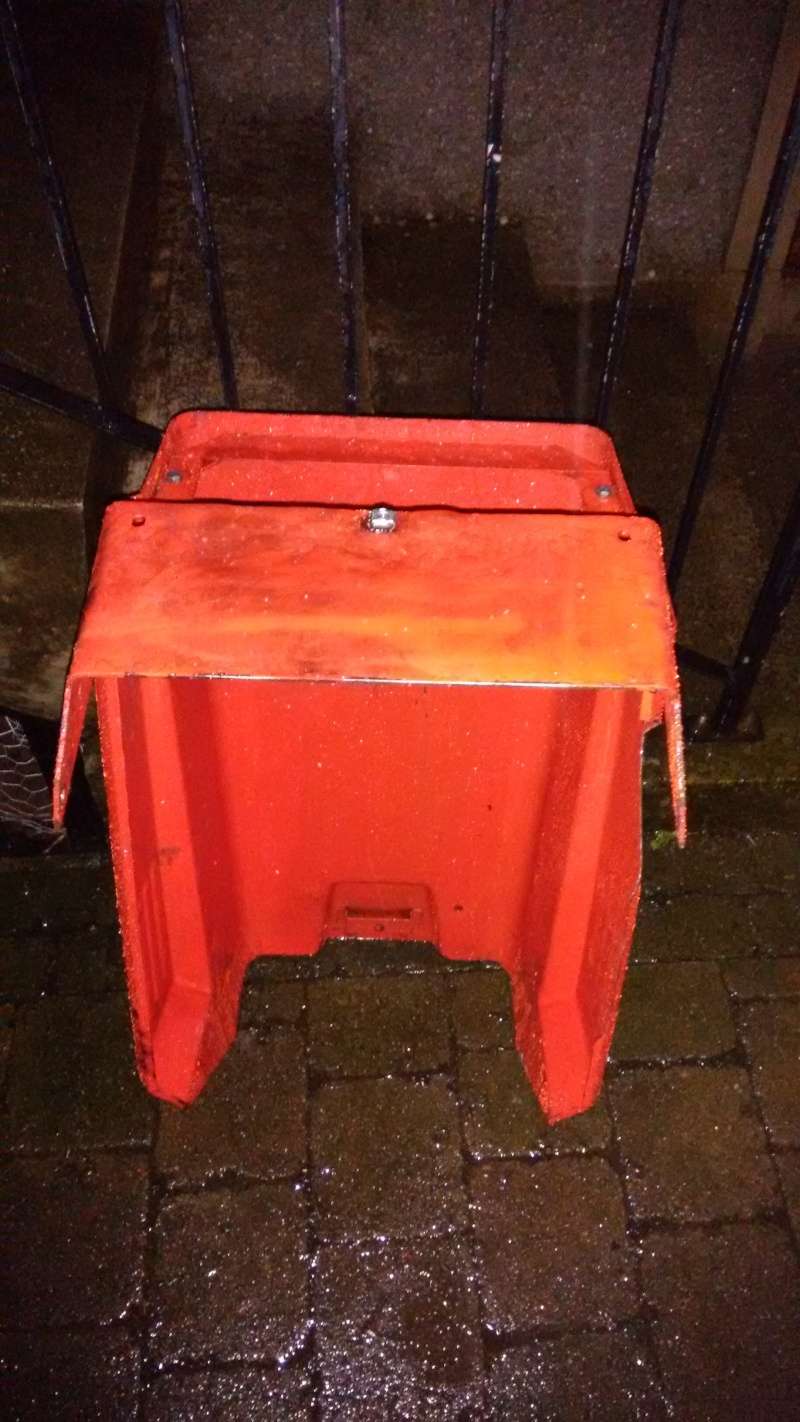

I removed the plastics from the hood, as they were bent and I wanted the classic "square" look with rectangle lights at the front
Westwood T1200 Offroad/Utility tractor Img_2011
This is what the front of the hood looks like without the plastics. I plan to bend some steel plate around that big gap and insert head lights there

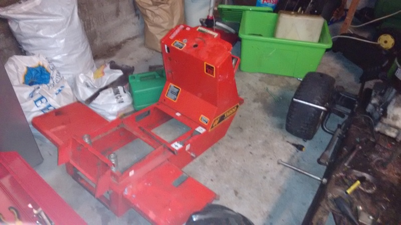

Westwood T1200 Offroad/Utility tractor Img_2012
Here is my box of parts for this build
I will be using the 12hp briggs and a peerless Mst-205 transaxle.
More updates to come shortly.
