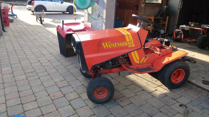

I recently picked up a Westwood T1200, one of the earlier models, 1986, with a blown 12hp I/C Briggs engine. I had a spare '98 PowerBuilt 12hp Briggs that I swapped in and got running.
I plan on making this a utility tractor - bumpers, rear atv rack and cargo space, pulley swap (want to be able to get from A to B quickly-ish without having too much RPM Wink - while trying not to chop it up too much, because it's such a nice mower.
For the drive train it has a 12hp Briggs, and a Peerless 801.
She also has a few neat features like a stitched leather steering wheel and a stock double pulley clutch!
This is what she looked like when I got it:
'86 Westwood T1200 Img_2027
I installed some 18x8.50x8 Duro Chevrons on the rear.
'86 Westwood T1200 Img_2030
This is where I'm at as of yesterday.

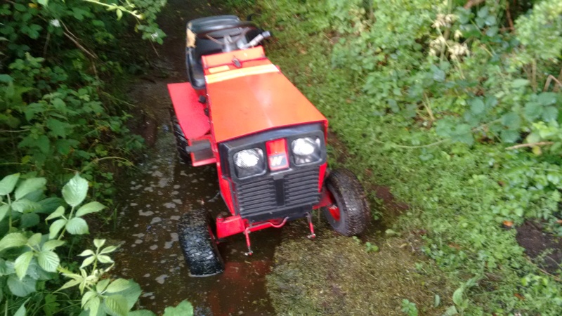

Haven't done much to this really except drive it around. I haven't had a running tractor in a while.
I went for a little drive down our back lane and in a couple of fields. We just had quite a bit of rain so it was muddy. I was very suprised at the traction it had, still not locked.
Pics!!
'86 Westwood T1200 Img_2031
'86 Westwood T1200 Img_2032

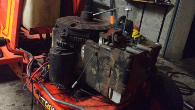

I've been working on the wiring and trying to rectify why the battery wasn't charging. Found out that the alternator was only putting out 2 volts. Been trying to remove the flywheel but my pulley puller isn't big enough to grab on the bottom.
It's fairly rusty so any idea's how I could remove it?
'86 Westwood T1200 Img_2014

There should be 2 threaded holes on opposite sides of the center of the flywheel. The idea is to bolt a flat bar across the center of the flywheel. In the center of the flat bar is a threaded hole. You thread a bolt through the center hole until it meets the end of the crankshaft. Then you continue to thread that center bolt in until the flywheel pops off.
When the flywheel breaks free, it can be very sudden and surprising.
You should be able to buy a "flywheel puller" (which is what I described above) from an auto parts store or a good hardware store for the equivalent of 20 US dollars. You will definitely need to remove several flywheels in your lifetime so you might as well buy one.
People will tell you to pry on it and hit it with a hammer, but I wouldn't if I were you. If you crack it, it can disintegrate later when the engine is running and hurt someone.

Thanks. Looks like I will try and make my own flywheel puller.
All the flywheels that I have had to take off in the past have come off by the method you mentioned not to use. Screw the flywheel nut down until it covers the tip of the threads of the shaft, pry it with a screwdriver and give it a dacent crack with a hammer and it usually comes off. Tried it with this one but it didn't work. My Dad mentioned getting flywheels off in the past by using spades! Very Happy

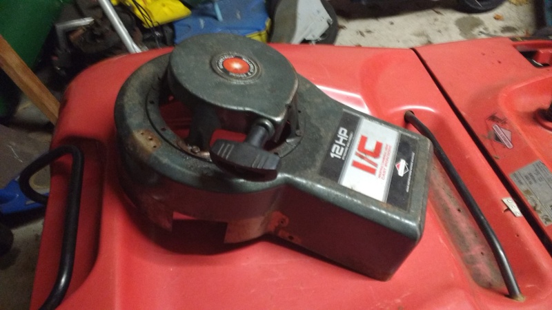

I dug out the blown 12 horse briggs that came with this tractor. It's got a pull start and starter clutch but unfortunately the crank shafts are different. The blown one with the starter has a long taper shaft at the flywheel end where as the other one doesn't.
The plan is when I have time to take both engines apart and swap crankshafts so that I can have a pull start back up.

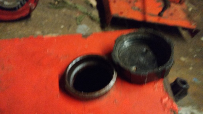

I also dug out the original metal fuel tank that came with the tractor. I added in a plastic one I had laying around because the cap on the steel one was a Quantum briggs that didn't fit.
But now I'd like to put it back in so does anyone know a cap that would fit this?
'86 Westwood T1200 Img_2017

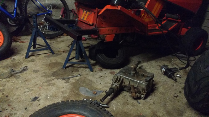

And finally, dragged the transmission out to try and solve the belt problems. I plan to cut a circular "disk" out of plastic (about 6" in diameter) so when the clutch is disengaged, the belt falls onto the disk, when the clutch is engaged, the belt tightens up around the pulley again.
'86 Westwood T1200 Img_2022
Thats all.
Sorry for the long post and I'd like to know your thoughts on the plastic "disk" arrangement on the transmission pulley.

And also, any thoughts on the fuel tank/cap issue,

Gas tank looks like it's supposed to have a tab type cap, like one that only turns about 1/4 turn. No idea what else would have one of those. I haven't seen them used too much on mower stuff here. Mostly threaded caps. What kind of box do you mean for the back? It couldn't be on top of the existing bumper somehow? Seems like the bumper is fairly low the way it is.

Yes, here is an ad for one which shows the cap
http://www.ebay.co.uk/itm/WESTWOOD-RIDE-ON-MOWER-METAL-FUEL-TANK-/131627061156?hash=item1ea5958fa4:g:0NsAAOSwA4dWHRx-

Not sure specifically where you can get your pulley, but if using the interwebs/ebay/amazon etc, try searching for a pulley designed for a larger belt type than what you run. For example, if your tractor runs a 3L type/size belt, look for a 4L or 5L pulley. This may help get you past your belt issues without having to find some special/custom pulley, or having to make one. Just a thought. Info on various belt sizes here. This might at least give you some terms to use when searching.
As for the gas cap, I dunno man. Maybe take the tank with you to a shop that services hydraulic systems on construction equipment and such. The only times I've seen tanks and caps like that around here were on hydraulic tanks on these machines and woodsplitters. Failing that, maybe a trip to a junkyard checking out automotive radiator caps? *Might* be able to find something that'll work. Just a shot in the dark there. Good luck!
