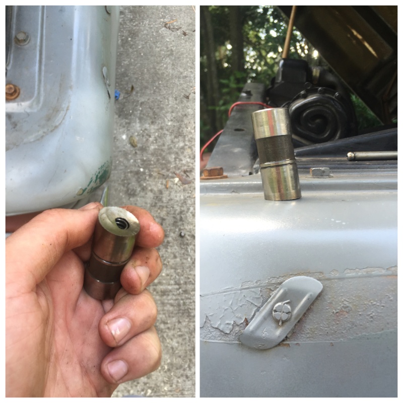

| Well the engine is probably toast. I have run it for about an hour the whole time that I have had the truck but the problem is from the last owner. I noticed it was smoking one day and pulled the valve cover and what I though was a stuck valve was worse than that.  Yes that is a hydraulic flat tappet lifter.That is the only one that I have pulled out and I am guessing more are bad because of the sheer quantity of metal in the engine. The previous owner must have done an oil change right before I bought the truck because the metal doesn't show up on the dip stick but when you look in the lifter valley there is defiantly a lot of metal that has been bouncing around in there and getting in the bearings that the engine probable needs to be gone through and I don't have the time or money for that. | |

| It would be worth a looksee to pull the motor and check the crank and rod bearings. Chances are it happened slowly and the metal particles are really small that if they made it past the filter into the crank bearing, they just past right through without damaging them. Those 400 ci motors, you'll probabley never find another one, well cheap anyways. Or see if you could salvage the crank and rods for a 350 ci stroker motor.
If it happened all at once, for example that could happen if the previous owner started the motor after it's been sitting for a long time without preoiling the motor. in this case the oil filter would have catched the metal and saved the crank and rod bearings. Well unless you actually heard a rod nocking | |

Well everything in the engine wasn't new, but when we were racing we put together engines almost monthly, so there were a lot of parts at the shop from ALOT of small blocks, we hardly ever ran the same set up, could have been lifters from one engine and camshaft from another, the only thing that would have been installed brand new would've been main and rod bearings, gaskets, seals. Nitrous is hard on them, even worse on alcohol! But I wouldn't have thought it had that kind of wear in it. You'd prolly be ok with another cam and lifter set. | |

| That's good, pullin the engine. Decided on what size cam yet? I suggest around a 265 or a 268 grind, more on the 265, the 265 is one or two steps above an rv cam with a slight lope to it and works OK with stock torque converters, but torque converter with a 500 rpm stall speed above stock will work best, for both cams. Plus both cams will work with the stock valve train as long as lift is under 1/2 inch so look at the specs of the cams. Reason for this is your overall setup of the truck, 400 with 2 speed trans and probably 4000 lbs of weight or higher of total weight. You would be after torque, not HP. The 265 can will give the best torque on the low end too. | |

| Oh and don't forget to break in the cam, which is 2000 rpm for 20 minutes, and use all the break in lube on the cam lobes so they don't wipe out again, and in the 20 minutes of 2000 rpm, give slight variations in rpm say every couple of minutes during break in. Then change the oil and good to go. | |

| I got the new cam and lifters in and have the heads torqued down. I thought hell lets see what the block casting number is and well I have disappointing news. The engine in the truck is not a 400. It has block casting numbers of 3970010 which means that it could be a 302, 327 or 350. I looked at the engine suffix code which ends in TJZ which means its a 350 not a 400 as I was told. | |
