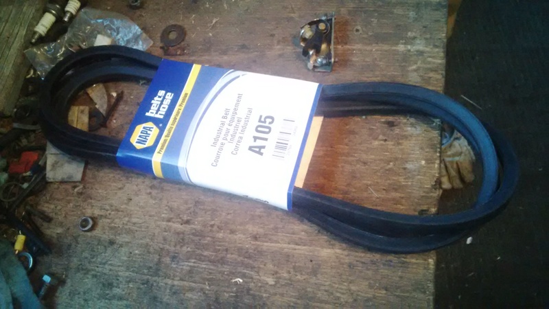

| Finally got a belt for the rat rod, I'll be haulin' grass in no time!!  | |
