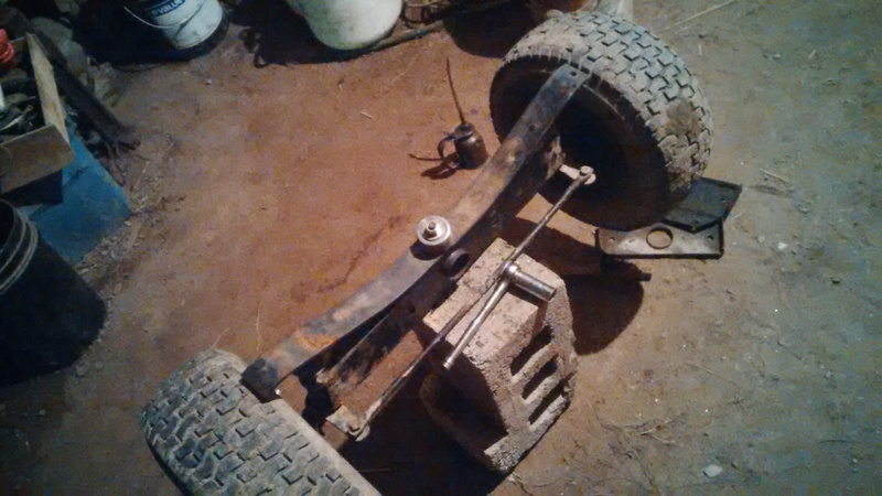

A wee bit of progress tonight!
The MTD sans front axle.
MTD off-road build (Mobile Terrain Dominator) "1" - Page 3 Img_2032
Then I stared mocking up the helper spring.
MTD off-road build (Mobile Terrain Dominator) "1" - Page 3 Img_2033
MTD off-road build (Mobile Terrain Dominator) "1" - Page 3 Img_2034
MTD off-road build (Mobile Terrain Dominator) "1" - Page 3 Img_2035
MTD off-road build (Mobile Terrain Dominator) "1" - Page 3 Img_2036
As you can see the slippers are awfully close to the tires, but I will be fixing that tomorrow. Let me know what you guys think!

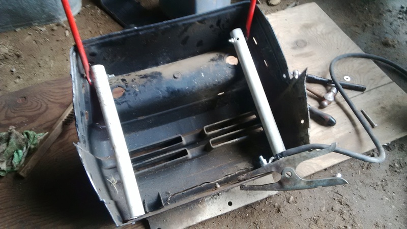

Okee doke! I'm pretty happy with the results of today's work, got all the issues pretty much sorted out. Here are a couple of pictures.
This is the actual spring set up.
MTD off-road build (Mobile Terrain Dominator) "1" - Page 3 Img_2050

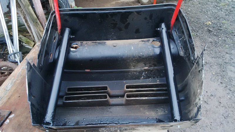

And I also braced my grille a bit
MTD off-road build (Mobile Terrain Dominator) "1" - Page 3 Img_2051
MTD off-road build (Mobile Terrain Dominator) "1" - Page 3 Img_2052

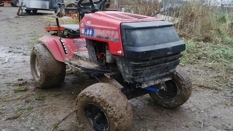

And finally, some post romp pictures!
MTD off-road build (Mobile Terrain Dominator) "1" - Page 3 Img_2055
MTD off-road build (Mobile Terrain Dominator) "1" - Page 3 Img_2054
MTD off-road build (Mobile Terrain Dominator) "1" - Page 3 Img_2053
MTD off-road build (Mobile Terrain Dominator) "1" - Page 3 Img_2056
