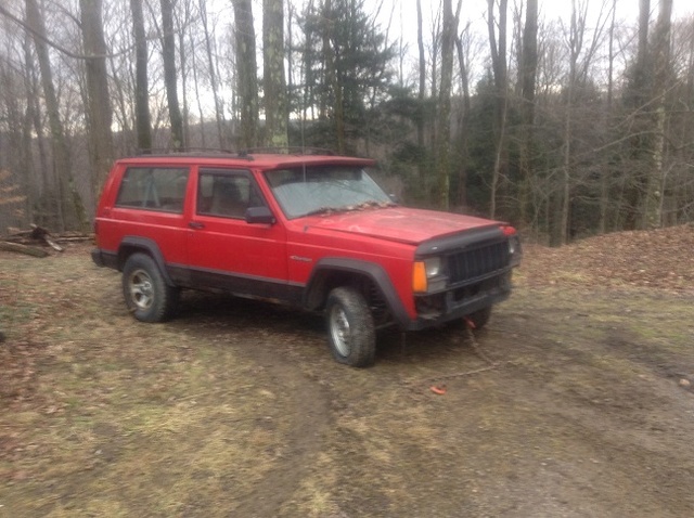

| I bought this Jeep because it is a 2 door with a 5 speed. And it has a cool visor thingy. It needs help. Lots of help. The Rockers and shot. The floor is shot. There is no patching. Oh, and the engine is blowed up. It came with a replacement. I call it "The Garbage Jeep" because the former owner left it a mess... candy wrappers, cigarette butts and whatnot all over. It was kinda gross... If I was smart, I would have made them clean it out... maybe next time I buy a piece of garbage. Ha.  It did have a bumper... but we pulled it off trying to pull it home. We dont need no wimpy bumpers anyways...  They used liquid nails to glue down a sign in the back.  Rust is a terrible thing...  I figure this ought to be good for an additional 5 or 10hp... | |

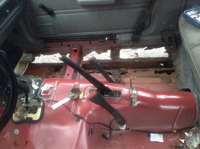

| Problem with the 340 is I dont have any of those laying around. Made the fist mistake today. Just a speaker wire is all...  ...wasnt planning on putting those speakers back in anyways... This is the worse of the 2 rear inner fenders. I assume theres nothing wrong with trimming it to good metal?  This is one of the worst bits of rust in the frame.  Ive been using a hammer and chisel to peel up the floor, and break it off the spot welds. Some Ive manage to chisel off pretty well flush... I used the angle grinder with a cutoff wheel to score the floor into sections to make it easier to remove. Ill go through after the floor is all off and grind the spotwelds flush. Had a though for the back... instead of getting brand new metal, going to the junk yard and liberating some metal from the bottom of a truck bed. Figure it would be cheaper, and it would have them fancy groove thingys.... The downside to that, there is more space between the frame and floor that isnt getting welded... maybe that not really a problem... ? | |

| Yeah a truck bed sounds like a good idea. I'm a ford guy, but they tend to rust out. A chevy bed will probably last the longest. | |

| Ill have to browse the Dodges first... gotta keep it in the family you know? On the same note as the truck bed... Maybe I can liberate even more from a roof or something for the front floors... Im not sure what would have thicker metal though, I wanted to replace it all with something thicker as that would be a bit easier to weld. I would think that truck bed floor would be thicker. Stock stuff was 18ga so says the internet experts. | |

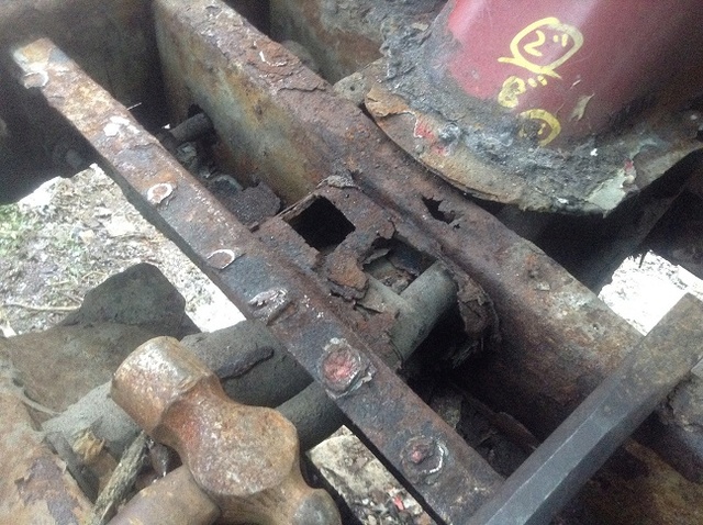

| Heres bad places in the frame, where Red said theyd be.   The will be plated sides and bottom. Id like to try get something on the inside aswell. Gona have to get some prices on metal before I decide what to plate it with... Im thinking 1/8 should be good. Aperson can buy frame stiffeners that would cover that, they are 3/16 and about $100 I dont want to spend. I need to get some braces inside the cab, that rail going across should be connected to the body. It is on the passenger side, driver side not so much. It didnt rust off, it broke. So the drive side sits about 1in lower that it should. | |

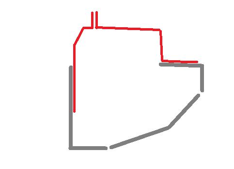

| Here is the plan for the rocker panel... The red is what I have that is still solid. Grey is what I want to make out of 1/8in material. Does this look like it should work? Seems like it would to me but...  | |

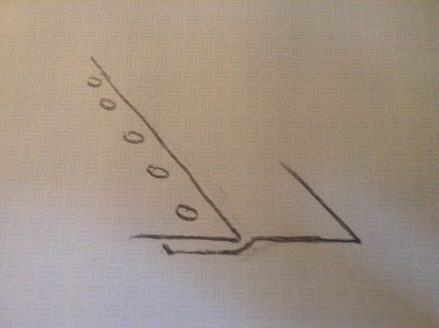

| So in removing the oil pan, I had to unbolt and jack up the transfer case... I also managed to tweak the body so the passenger door hits the visor... oops. Hopefully some strategic plating on the frame will stiffen things up and remedy this problem. Come to the conclusion I dont want to try to make the back from 1 piece, as there wouldnt be much room for error. I can use 3 however and have loots of room for mistakes. Hopefully not too many. Butt welding 2 pieces of sheet metal doesnt sound like fun. A flange will make for some easy plug welds.   | |

| use your wirefeed when it comes in.... rather than try to run a continuous bead initially, stitch it every half inch or so with a button (tack) weld until the panel is in place and lined up.... THEN you can weld it up fully, with much less distortion
and 1/8 inch is far more than needed.... try 16, 14, or 10 gauge I can do anything I set my mind to... the impossible just takes me a little longer Tech Manual mod, If ya need it, and cant find it... Just ask.... Pm if I'm not on line | |

| Yup, I dont want to tweak the body any more than it is.... I like the idea of 1/8 for the bottom of the rockers, more solid is always a plus. The floor, if I have to buy material that will be 14ga. Thats what I need for my pps43 and kp44 so if I have extra thats a plus. | |
