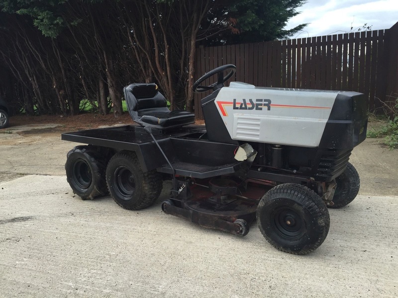

A 4x6 - nice! Reminds me of a 4x6 mower I saw on ebay a couple of years ago. It had 2 transaxles with independent shifters. Looked really cool.
my 1st major build attempt  110
I remember ypu showing me that thing!! Haha, it was super cool.
that is a really cool looking tractor, initially i planned to use 2 hydros for this build, i already had them and they were identical transaxles out of two mid 80s mtds me and my brother got for doing some work for a friend, and they both worked great, but that plan went away when we had to retrofit one into a 2013 cub cadet we sold that had a bad hydro in it, i still have one hydro i can use but it needs taken apart and cleaned, it had water in the oil, plus the clip that held one axle in broke so the shaft comes out, but i'm still keeping that as an option, atm my plan is to run a chain from each axle shaft of the transaxle to a solid axle in the rear, basically exactly what murray mayhem did on his murray-gator build
