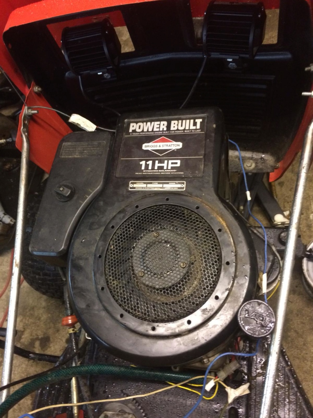

Test ran the Briggs & discovered that this Muffler sounds extremely horrible, so I might make something different, since this damn crapmuffler also blocks the access to the front axle where I need to mount the plow But the Glasspack is too loud for the next Owner... when he is mowing tall grass the engine sounds too nice for the neighborhoods ears.
Swapped the Engine back to Stock (stock Shroud & Stock Air Filter)
