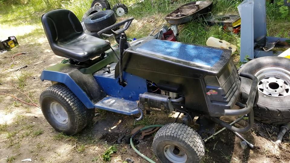

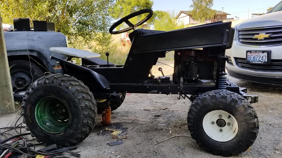

|  This little project LT I picked up a year ago when helping an older fellow clear his property for fire safety. Is now powered by a honda GXV340. Hasn't gone much farther than the picture here which was taken just before I moved. 6 Speed spicer 4360, 1:1 pulley ratio. Wiring nightmare I call 'Predator' (because it's whisper quiet and fast...ish)... Back burner, but will be revisited sooner or later.   This is one of my current big projects - a 1976 Dynamark LT mated to a late model LT3000 pan frame, mated to a partial tube frame of a 1983 Yamaha G1. It retains the front and rear sections of the G1 with the front suspension intact. Currently running a 2 speed foote inline shift transmission to the 8:1 ratio rear end. This will be replaced with a solid 1" axle, either modified 3 speed foote or peerless 700 and +/- 40T rear sprocket running #480 chain. Likely similar tires to what it has in the 2nd picture, but possibly something larger with a regear accordingly. It's currently called 'low buck Chuck' cause I've spent next to nothing on it.  This is my LT4000, formerly known as 'General Hellcat'. It is slated for a complete rebuild and mod with box/tube frame underneath the original pan frame, ross box steering and a chain drive front and rear. At least, those are the intended plans.  My 1973 Bolens HT-20 the day after I got it. Originally I intended to mod it with a subaru engine/trans/rear axle setup (ea81, 5 speed, IRS) but have since made enough mechanical repairs to use the original drive system. I am going to locate a nice diesel for it, but have not found just what I wanted yet. It may end up as a 6 wheel machine, used for tractor recovery. If not, a standard four wheel machine, with similar tech to the roper GT180 I've been working on. In addition, it will have a winch front and rear, likely a tow boom, dual batteries, dual fuel tanks, onboard air, etc. It's been running once with a k321 since I got it, but have removed that engine in search for the diesel.   Picked up this GT180 roper clone last winter. First pic is as it was when I picked it up. Second is as of yesterday - and it's gone through some further changes since then. It has a 22hp predator 670/633A setup, 1:1 ratio. Full ATV rack, running a 950A deep cycle battery, and enough LED to light up next week. I'll be dropping a video on this either on FB or youtube in the coming days summarizing the whole build. | |

| Some neat stuff you're building here. I really like that little Craftsman LT with the IFS! _______________________________________________ "This'll either wake you up or put you to sleep forever!"- Red Green "Whatever you do you should do right, even if it's something wrong." - Hank Hill - MTD Off-Road Build - Ford LT 110 Off-Road Build - Craftsman GT 6000 Off-Road Build - Sears LT11 Rat Rod Build *2019 Build-Off Winner!* - Allis B-110 x2, 710 & 716 - Wheel Horse 655, 953 & 500 Special - Case 444 - Bolens Versamatic & 1668 - Cub 106 & 124 - Ford LGT 125 & 145 - White 1650 Yard Boss | |

Thanks  it's probably my favorite right now as well, which is why it's taken me so long to get anywhere on it. I want to do it just right, the first time and then thrash it like it owes me money lol | |
