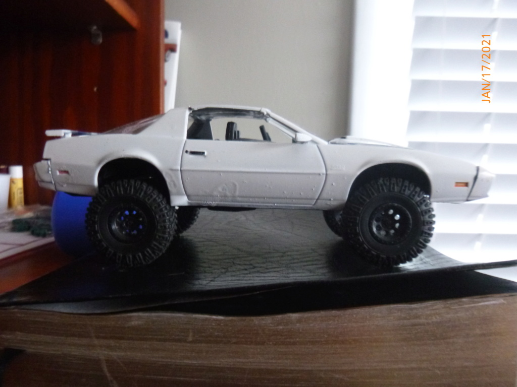

Lol, well I'm not building it yet but I've planned to build a 3rd gen Firebird for 4-6 years now. The whole time I've had the vision, all I knew is that it would be a lifted 3rd gen Firebird with some type of cummins and a classic firebird white and blue paint job with red accents. Now I'm starting to plan it out a little more thoroughly. I built a model of it a few years ago...
1994-2001 Dodge Ram 12 Valve Questions P1150917
1994-2001 Dodge Ram 12 Valve Questions P1150918
Don't ask why, I don't know either. I don't even know where I got the vision, but I like the vision and that's that.
