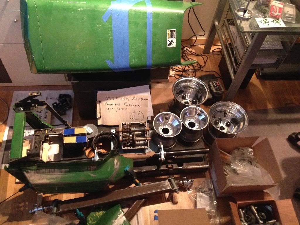

| Parts pile, well those i have.
This will be lowered, shortened and slammed to the ground to make a "Shrinked JD210R". Trying to maintain max lenght of 40".
I dont have a dashboard/ steering support, so I need to make one out of sheetmetal. Hood will be cut short and modified to fit. It's also missing a grill, so will need to make one, and the frame I'll use the Craftsman LT1000 frame and cut and custom build it to be ministyle.
It will house: aka (parts on the way).
Briggs 20HP V-Twin Vanguard Peerless 700, Race prepped to run on gearoil. Solid 1-1/4" Live axle, and solid front axle. 13" Tires front & 16" Rear Turf Tires.
