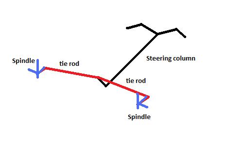

I'm completely sold on using motorcycle handle bars for my tractor build. Since the handle bars will have a very limited amount of travel, it's obvious I need to do something to increase the steering ratio. After looking at it, I can see one pivot point I can change, and I can also lengthen the arm that comes from the steering rack. These two things will help, but I have a feeling it will not be enough.
Certainly someone on this board has been here before. Is there a manual steering box people are using from an ATV? Any suggestions?

ATV's don't have a steering box. They run similar to go karts with a straight shaft to an arm and two tie rods.
Using Motorcycle handle bars / need quick ratio steering Untitl11
Also Do a little research on the Ackerman. Its the spacing between the two tie rods where they bolt to the steering column/arm. It make it soi that the inside tire turn sharper that the outside tire during a turn

Thanks for the response chopperhed.
I'll look things over in the next few days with that in mind.
