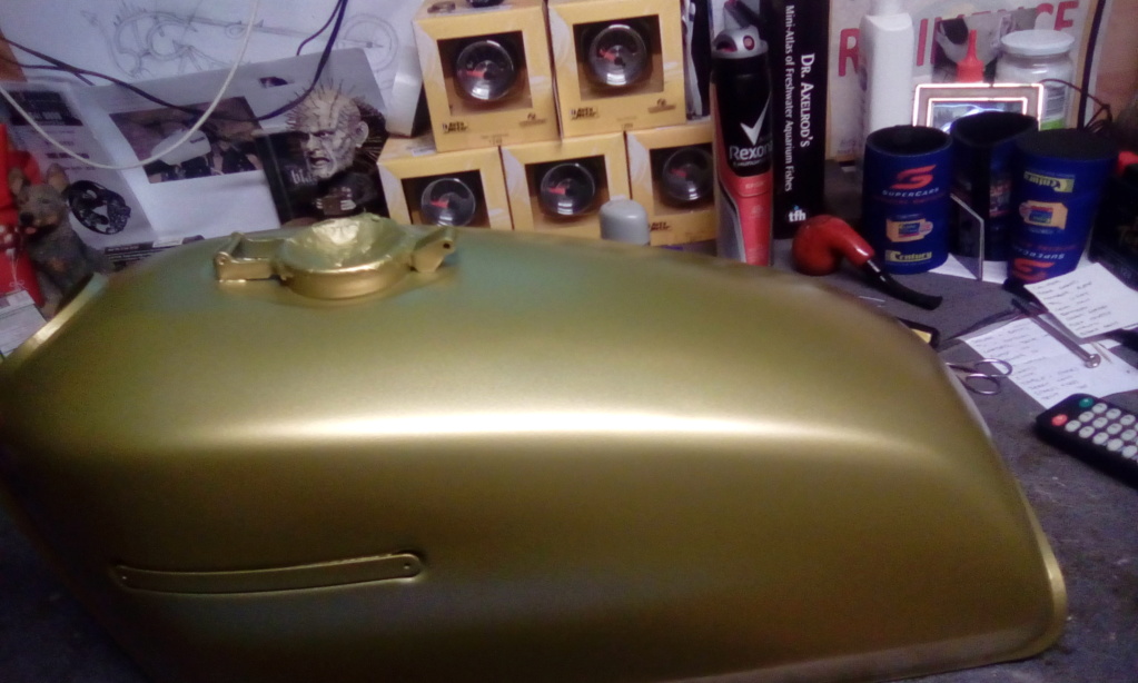

body work done, primed and gold base sprayed for pin striping

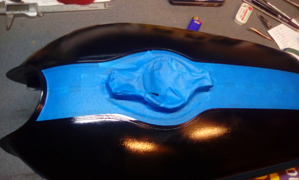

next step was to mask up the checkers down the backbone of the tank ready for the metallic black.

Black done and dusted, ready for the next lot of masking to make way for some more colour.

masked up side panels and the backbone area ready for some more silver.

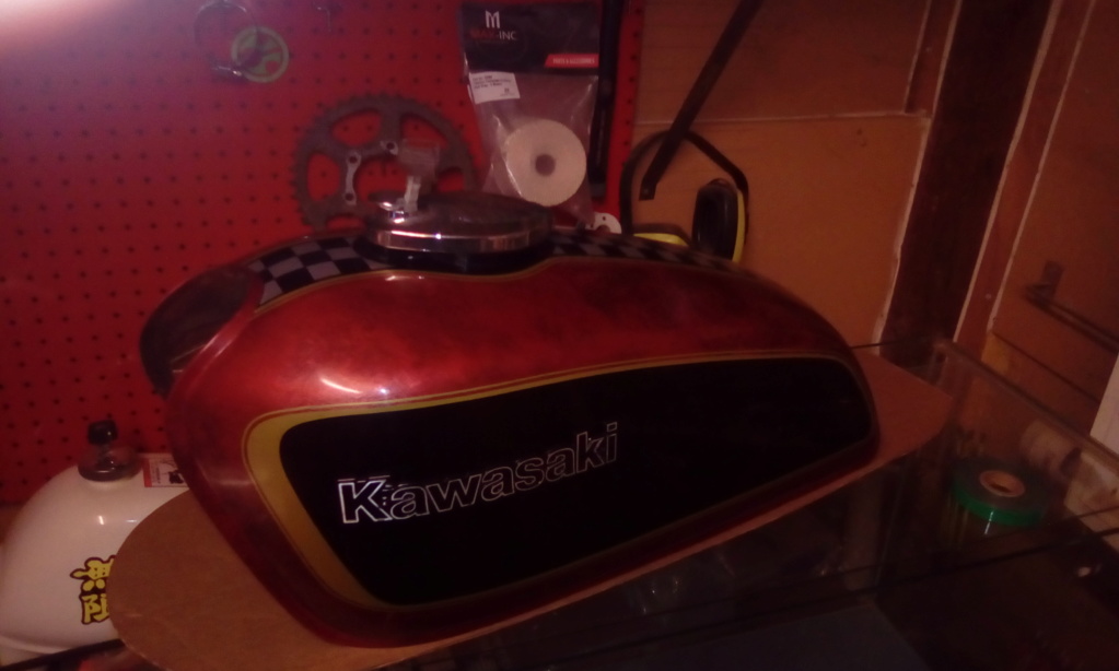

once the texture has been wet rubbed out working my way from  800 grit all the way to 2000 grit I then give a rough cut and polish until ready to install on the bike where it will get it's final mirror finish polish. cheers to all for your attention and hope I did not bore too much with this process, lol
