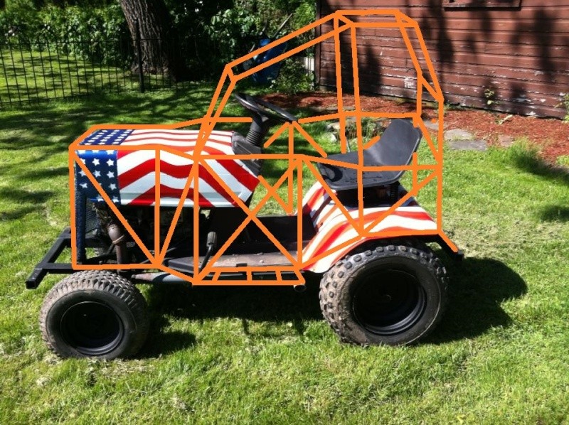

 | Subject: Re: Rustey Medal May 29th 2013, 4:01 pm | |
| well one of the two designs I just thinkin  I like this one better  | |

 | Subject: Re: Rustey Medal May 29th 2013, 4:37 pm | |
| Also Redline i like the second one. And you should do a exo-cage on your mower it would stifin up the frame and it would look cool. | |

And you should do a exo-cage on your mower it would stifin up the frame and it would look cool. Yea I need the seat lower so the roof isn't as tall | |
