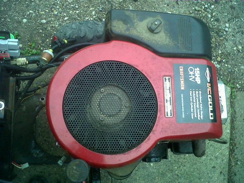

Okay- If the weather will co-operate with me this weekend, I guess I got some work to do! Got me a 1994 28ci 15hp OHV Briggs single to go in. Ain't gonna be plug and play, though- the exhaust dumps on the right side of the tractor (not the left like the flathead) and thanks to the OHV design, I now have to completely re-do my winch mount, moving it forward 3" or so.
On the plus side? 3hp more, and an OHV... Bring it!LawnBoy UTLTV aka MULE - Page 4 15hp110

Yes, they are. Here's the obnoxious part-
About a year ago, I got rid of an identical engine. I just never foresaw using it! It wasn't big enough for my racer, and I had no other tractors... Way to go, stoopid!

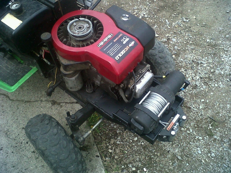

Okay- the weather was decent enough today, and I got at 'er!
Reconfigured the winch mount and fairlead, to move them 3" forward. Bolted the engine in, got everything connected, changed the oil, and lit it. The engine started right up, and ran like a champ from the word "go". I did some hacking and welding to relocate the exhaust system to the other side of the tractor. When I went to out the belt back on, I found that the new engine/pulley combination located the pulley an inch or so too far down. After examining things, I grabbed the pulley off the original engine, and that put the belt in the right spot.
Got it all back together, and had a great romp in the mud.

how far did you have to move the winch forward

3". I used the old front mounting holes for the back of the winch, and built up the front platform and new front mounts using some 2" angle and some 3" plate.

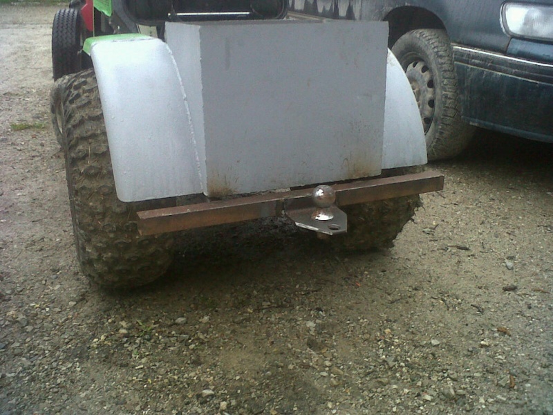

Well- the weather totally sucked today. old, windy, wet... Even a bit of s***!
I only spent about an hour outside, long enough to throw together a rear bumper and hitch. I used some 1" thickwall SHS to run from the transaxle brackets back to the bumper, and some 1 1/2" SHS for the bumper itself. I will cap the open tube ends on a nicer day. The hitch platform is 3x4" 1/4" angle, cut and shaped to suit.

do you have any other braces besides the trans axle mounts

Not yet. It was raining and snowing and hailing... There were locusts, the bubonic plague... LOL- the weather sucked, bad. I stopped before I could get that far. I was thinking about secondary bracing.
