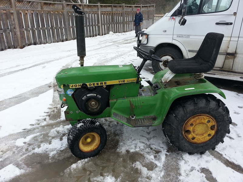

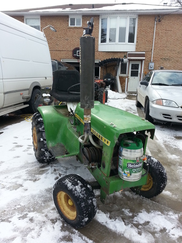

Well... It was quite a task getting it back together with the new engine in. The factory fuel tank would no longer fit with the Vanny in there, and I had to hack part of the tank mount bracket to clear. Sooooo... I built the Heineken minikeg fuel tank, fabbed up a bracket, hung it, and plumbed it.
Next... The exhaust. I cut the port flanges off the factory muffler, and ashcanned the muffler. I bent up some EMT and messed with it until I was happy with it. Bolted the flanges to the engine, and tacked the EMT to the flanges. Removing it again, I burnt in the flanges and used a scrap of 2" pipe beaten to shape to make a collector. Burnt that in full, and re-hung the whole thing on the engine.
I grabbed a used Hindle Stealth carbon fibre motorcycle muffler that I been saving for a special occasion, and used a plumbing coupler to attach the pipe to the collector. Here's the beauty: The couple (minus the rubber insert that comes with it) is thin, corrugated stainless steel, and secures nicely with two attached hose clamps. It gets a good grab on the pipes, but is weaker than any other part of the system. IF I should smack the muffler off something, or roll the tractor, that joint will let go, sparing the engine from damage. Later, I will attach a brace from the collector to the tractor chassis. What's also nice is how light this muffler is.
Turning to the hood... The factory hinges were big, cumbersome buggers that were hitting the airbox. I wanted to keep the airbox because of the 1 1/2" round intake tube, that will be dead easy to attach a snorkel to. Hacked off most of the factory hinge mechanisms off, and did a little reconfiguring to re-attach the hood to the hinges. Closing the hood, I could get it past the body of the airbox now, but hit the intake tube. Little jigsaw work there. Lastly, a pair of rubber bungee-type hood latches. Done like dinner.
Damn this sounds nice. Expect a video the next time I have nice enough weather.

This just PROVES that there truly ARE Canadian Red Necks... Take ME out for some HIENEY...

Yup! Git-R-Done!!!  lol!

I would wind up busting that tall stack off pretty much right away. Cool work though.

I cant get over the look of the rear lol looks good

that gas tank definitely adds some character lol
Better that, than breaking the heads! Yeah- I don't know what it looks like form there. It's not particularly tall, I tried to find a balance between the ol' smoke-in-the-face, and interfering with air traffic. I think it's okay, for me at least. Where I ride, anything that really would threaten that, is threatening my upper body... LOL
This build is sorta directing itself...  affraid
agreed. Lets hope eh dont hit anything to hard...
By the time the front bumper and guard are done, I'll be able to square this thang into a brick wall, and the tank won't even blink.

Yea, the stack looks high from here!
Personal preference, make it through the hood, like an old time tractor, then use a 90 on top to direct it to the side.
Leaving the wheel weights on it?
1st Place 2016
1st Place Winner 2016
Age : 50
Points : 6892
Posts : 2914
1970 John Deere 112... The beginnings of MULE II - Page 2 Empty
PostSubject: Re: 1970 John Deere 112... The beginnings of MULE II   1970 John Deere 112... The beginnings of MULE II - Page 2 Icon_minitimeSun Mar 16, 2014 7:05 pm
I thought about it, but one of the fullsize tractors I use time to time has that, and I consider it a pain to take the exhaust off to open the hood. Plus, the hood is fibreglass. Heat- EEK!
The weights are there to give it more grab in the snow ad such, but i suspect I will be taking them off when it melts. As I add more weight (accessories etc) the wheel weights will likely prove unneeded if not overkill.
