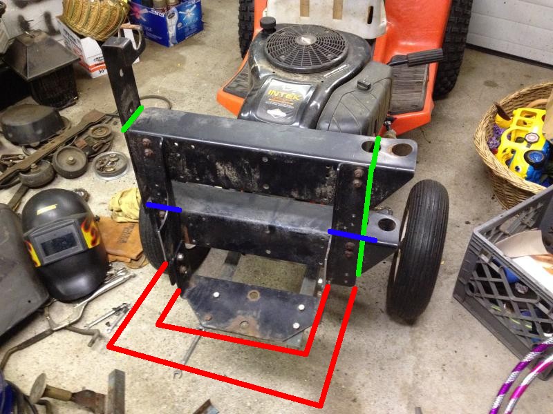

Worked on making a bumper today. Found an MTD bagger mount in the scrap pile.... looked like a bumper to me cheers
Scotts S1742 Trail & Trailer Pulling - Page 2 IMG_2106_zpsdd3ddb37
Used a few pieces of a bed rail to make supports coming off the frame. This frame is horrible for front end add-ons.
Scotts S1742 Trail & Trailer Pulling - Page 2 IMG_2107_zps1e7ccb73
Here you can see my header and muffler from a 2008 B&S 21hp. I had to move the support over because of the pipe location.
Scotts S1742 Trail & Trailer Pulling - Page 2 IMG_2109_zps81b3d69c
Everything is bolted together. The welder was sitting next to me, but I didn't feel like using it. The bumper is there for two reasons other than protection; mounting lights, and adding weight to the front.
Scotts S1742 Trail & Trailer Pulling - Page 2 IMG_2111_zps1aefdd0d
I've got two more brackets to weld on and then I can hang various pieces of heavy metal off it. That way I don't have to shift my weight forward while turning to get the front tires to grab.

Were I you...
Scotts S1742 Trail & Trailer Pulling - Page 2 Cut11
I'd cut it off vertically at the green lines.
Then cut it horizontally at the blue lines.
Then cut a piece out of an old mudflap, and lay it on that bottom part. Set a full size battery there. Then use the big piece that you cut off, in front of the battery.
Kind of like if you cut all those lines, then "Hinged" at the blue lines, and let the piece fall forward. Move it down until it is surrounding the battery, just like the red lines, and weld it in place.
There you go. Big beefy bumper for protection, and a full size battery, for weight.
Angchor
Angchor
Age : 65
Join date : 2014-04-14
Points : 3813
Posts : 491
Location : Index, Washington
Scotts S1742 Trail & Trailer Pulling - Page 2 Empty
PostSubject: Re: Scotts S1742 Trail & Trailer Pulling   Scotts S1742 Trail & Trailer Pulling - Page 2 Icon_minitimeJuly 29th 2014, 3:34 am
Ok, wait. I just had a better look at the other picture.
Scotts S1742 Trail & Trailer Pulling - Page 2 Cut211
Unbolt the red piece and remove.
Cut along the green lines.
Then flip that piece, following the yellow arrow.
Line it up. Slide it back some, drill some holes and bolt it on.
No welding!
Now fill the bottom of the cavity with a piece of mudflap or something similar, and place a full sized battery in there.
