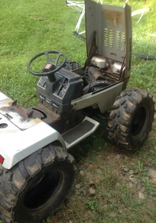

Started with this. Broken transaxle turned out to be seized with rust and a bad bushing.
Had a FNR transaxle apart and happend the bushings fit the spicer. Back together and it seems to function.
Its a 14.5hp OHV, and a spicer 6 speed. How does spicer rate in the world of transaxles?
Some sort of craftsman... and more! Img_1410
The back is lowered about 6 inches. Now it needs a jackshaft.  Some sort of craftsman... and more! 2429134702

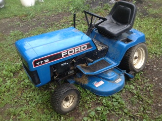

Got this ford for free...
Some sort of craftsman... and more! Img_2110
But whats this???
Some sort of craftsman... and more! Img_2114
Some sort of craftsman... and more! Img_2115
Some sort of craftsman... and more! Img_2112
Oh bother...

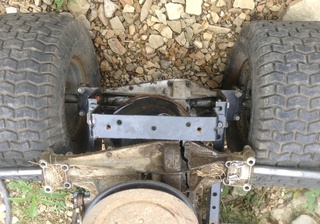

...just so happens, the transaxle from the craftsman "thing" is the same case.
It was donated to the cause. The axles are about 2in longer so i had to swap them. Seemed to work fin for a while, picky shifting. Recently it started doing something goofy, like its kicking in and out of gear in the lower gears, but goes fine in a higher gear.
Some sort of craftsman... and more! Img_2113

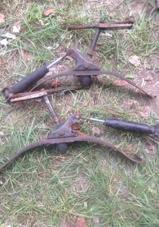

...and on another note... I saved this peerless from the scrap yard for a whopping $4.
Some sort of craftsman... and more! Img_1712
It has the same mounting patter as this foote. Ill use the foot till it gets blowed up...
Its too bad, the shifter on the foot is more cooler...
Some sort of craftsman... and more! Img_1713

Nice, is that an opposed twin in that Ford?
Points : 5070
Posts : 1369
Some sort of craftsman... and more! Empty
PostSubject: Re: Some sort of craftsman... and more!   Some sort of craftsman... and more! Icon_minitimeSeptember 1st 2016, 6:59 pm
Yeah, 16hp kohler. it was parked empty, with some fresh gas it started right up.

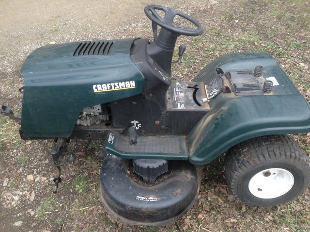

The green one turned into that gasser looking thing. I scrapper the hood and fenders as they were not anywheres near my manly requirements.
The gasser thing gave up the transaxle so I could get that ford running as Id like to try and sell it.
Ill keep ahold of the frame from it for a while as we dont know what the future holds...  I still think a gasser looking thing would be fun.
Ive been saving those older craftsman chunks for years... contemplating a number of options, I think Ive settled on a hotrod/offroad/racer-esque thing.... or whatever it turns into I dunno? lol!

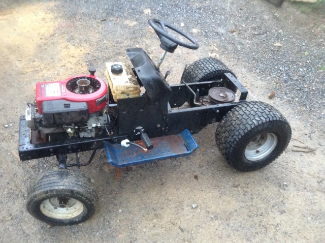

No no, "Green Thing" is out of the picture. "Purnurple Thing" is getting a scratch built frame outa some 1x2in tubing.
Speaking of the frame, Ive come up with a basic setup. Im not sure the exact lenghts and everything, its kind of "by the seat of my pants" thing going on here. Pretty simple in my eyes... Im not sure how the steering will be, or the rear axle... or much else... I dont know whats going on... scratch
And here we have for your viewing pleasure(or not?) a side view of the frame and some "conceptual art"...
Some sort of craftsman... and more! Img_2313
Ill probably make the frame long, then cut it down after I see how things are going fit. I dont have long pieces of tube, I will need to join several pieces. I figure where its joined is a good place to add in a crossmember.
Frame will be 12 1/8 wide outside to outside, the dash will fit nicely.
Having the step in the frame, Im thinking theres a possibility of rear suspension if I can find a short(and cheap) shocks. I can always add it later too. Ide like to build the front in such a way it would be easy to add front suspension aswell..

So Ive started cutting the material for the frame. Ive got the pieces for the back half cut... and now before I cut the rest, Im wondering if maybe I should make it so the front half is narrower. Im thinking about single a arms up front, but I dont want it to be half a mile wide up there....
Or, what are some other simple front suspensions I could try to rigafy up?
As metions before, the frame will be about 12 1/8 inches wide, I supose it would be fine?
Some sort of craftsman... and more! Img_2314
{EDIT} I guess I cant narrow it too much. I wanted my engine mounts on the inside of the frame. That being I could only narrow it to about 10 inches.
Ofcourse I may run into trouble with some suspension bit running into the engine. I might have to send the front end out past the end of the hood? That might look interesting...
scratch
....maybe I just build it without suspension...
{EDIT} #2! Or maybe I just build some tall spindle brackets and stuff a big valve spring in there?
