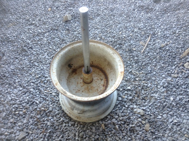

| So, onto the 8in wheels... Thought about how to chuck them up, found this hunk of 3/4 round with a keyway in it. Yes.  Then, just for giggles I set up the dial indicator. A whopping .130 out of round. 1/8in is .125. It was pretty bad the other way too, about 1/4in. Thats not really a problem, but by the time Im finished with these they should be a bit closer than that...  Now that its chucked up. Started to whittle out the center. I didnt have a setup where I could just plunge a bit strait through, so I had to carve out about 1/2in or so to make clearance for the tool...  Whittle some more... ...some time later.....Still whittling......  Still whi... Oh look! We are through 1 side! ...again, some time later.............Break though!  Now Im left with this. This could come in handy later... maybe make some 3/4in bore hubs for something else... ...and then, we start the whole process all... over... again...  I should have gotten another bushing. Without the right setup cutting these out on the lathe sucked. Next Ill need to carve out the inside to the same diameter, and if Im slick, Ill make the the same one the 6in wheels so Ill only have to build 1 jig to mash them together.... | |

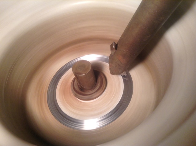

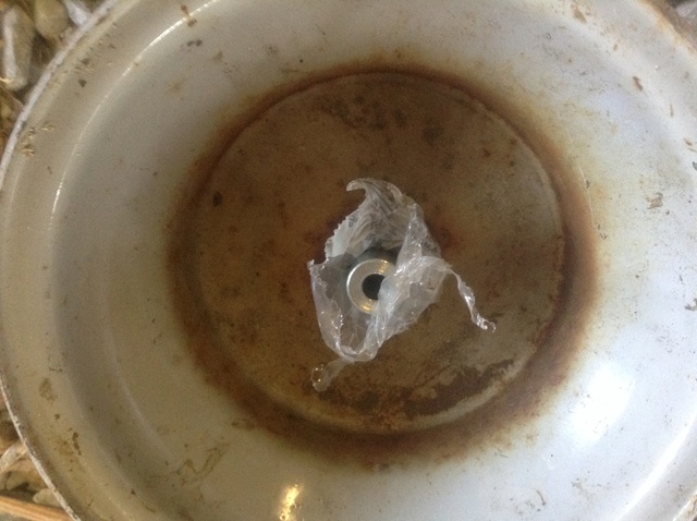

| Thanks! Started to carve out the inside.  Made em about 4in.   Might take more out, leaving about 1/4in to weld the plate with the bolt pattern in. Ofcourse, if I would have made these holes considerably smaller then I could have drilled the bolt pattern in the wheel without having to weld in another plate.  Still need to weld the seams in all the wheels. Didnt bore out the 6in wheels as I cant hold them in the 3 jaw chuck without a different set of jaws. | |
