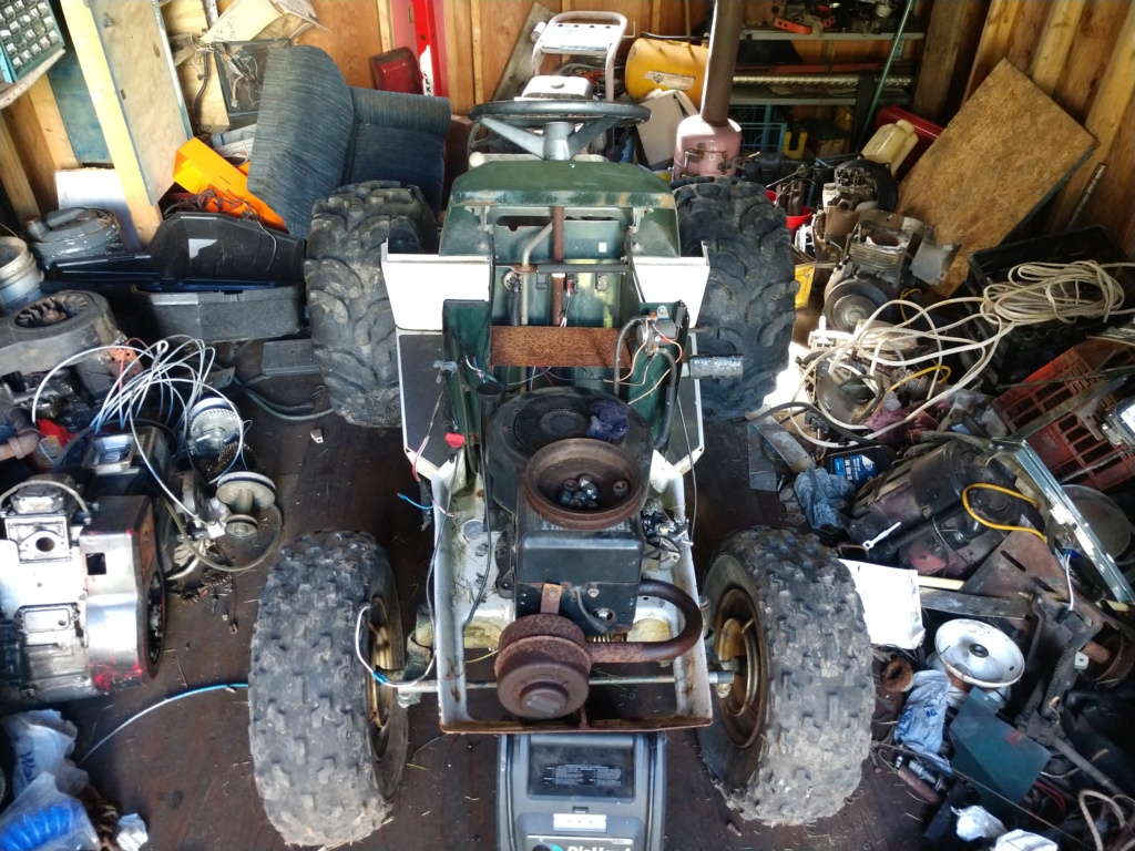

Here is the start of my build thread for my Bolens st110. (pics will come later) I got this as a rolling chassis from my good buddy and proceeded to build it as basically equivalent to fearlessfronts' Murray. It has a locked 801 peerless, 18 hp Briggs oppy, 18x6.5x8 snow hogs in front, 23x11x10 Dunlop Mule tires on the rear. 3k lb eBay winch on front, and custom wiring made from some of the stock harness and cables from a battery charger. (4 ga. wire) I'm running a 4" pulley on front and about a 6.5" pulley on the rear, and with the tire I'm running, it tops out at about 12-13 mph. (approx.) I got it together mainly to have something to plow with this winter, and so far, works great. There's lots I want to improve upon, and also build/reinforce along the way. It is an amazing platform to build on, and has a lot of strong features that lend itself to being a great romper. Stay tuned for more pics and upgrades to come.

Made some new rear wheels for it using a pair of Polaris 10x8.5 rear wheels and a cut down pair of Dynamark rear wheels. I welded the Dynamark wheel inners to the Polaris wheels and it actually worked out great. They are actually about 1.5 to 2" wider than my stock wheels. I'm gonna use the stock wheels on another build, which will get its own thread when the time comes. I'll get pics up tonight.

I have a little wobble on one, but it is not noticeable while driving at all. If I had tubes, I would put the other pair of tires I have on that are a little more agressive. But for now, these mule tires seem to work better than they did before. I'll try to get a better picture in daylight.

The bolens is getting some new mods this year. For starters, it has a 12.5 hp flattie swapped in place of the oppy that was on there. I took the winch off the front, never really ever worked correctly anyways, I am building a brush guard bumper for it, bigger front mounted gas tank, relocating the battery, building an under seat storage compartment, bigger front an rear tires, and probably adding rear taillights. Also gonna build some sort of quieter exhaust, it was kinda loud with the twin and the stock muffler. I'm gonna be giving my kids rides and don't want it real loud for that reason. Will get pics of before and after as I'm building it. Will also get video of things on my channel as well. Thanks for tuning in.

PostSubject: Re: Bolens st110 build   Bolens st110 build Icon_minitimeSeptember 30th 2019, 11:15 am
Sneak peak:
She getting big...... Bolens st110 build Img_2010
