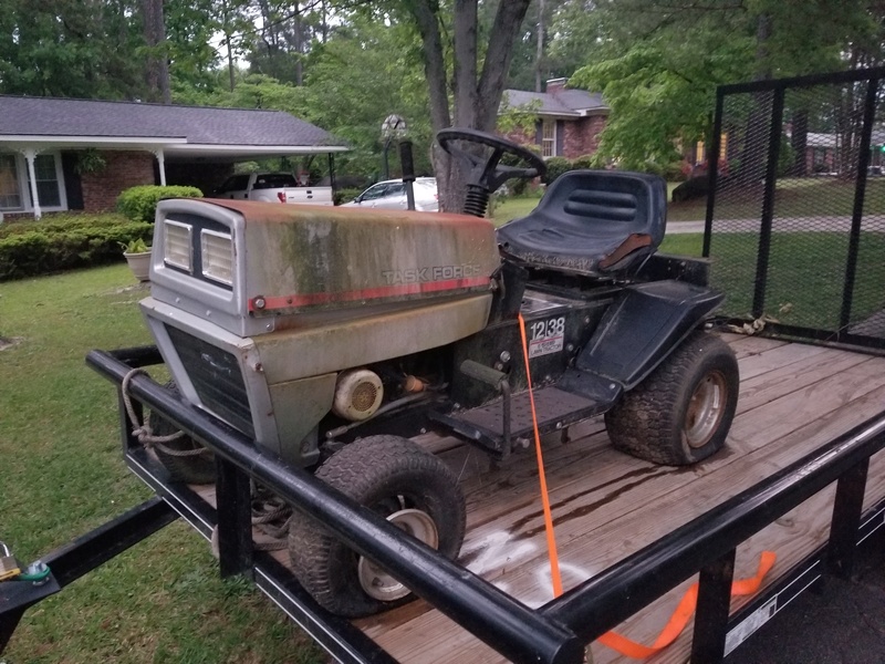

| Hey Guys, I am new here but I am starting my first build with a 1989 Task Force 95185 (MTD) riding mower. It has a 12HP B&S on it (Model 280707 0128-01). The motor hasn't been cranked in a year or two. I acquired it from my father when I took over the family farm. I am planning to use this as a buggy for the farm to haul my chainsaw and gas around. It will need to be able to go in to the woods, fields, and some boggy areas with me. I am excited to get this underway! Let me know of any pointers or suggestions you guys have! Plans: Oil change New spark plug Clean (rebuild maybe?) Carb Flush Gas System Buy new tires - Aggressive tread (as large as I can - maybe new rims to accommodate a larger tire up front) Remove mounting brackets for the deck Change out rear pulley for smaller pulley Power wash it CLEAN Weld up rear basket for carrying stuff Weld up simple front bumper with Fog lights New paint all over

| That engine doesn't have a "tag" the numbers are stamped into the front of the blower housing, right above the spark plug. Does it have the FNR and vari-drive setup? | |
