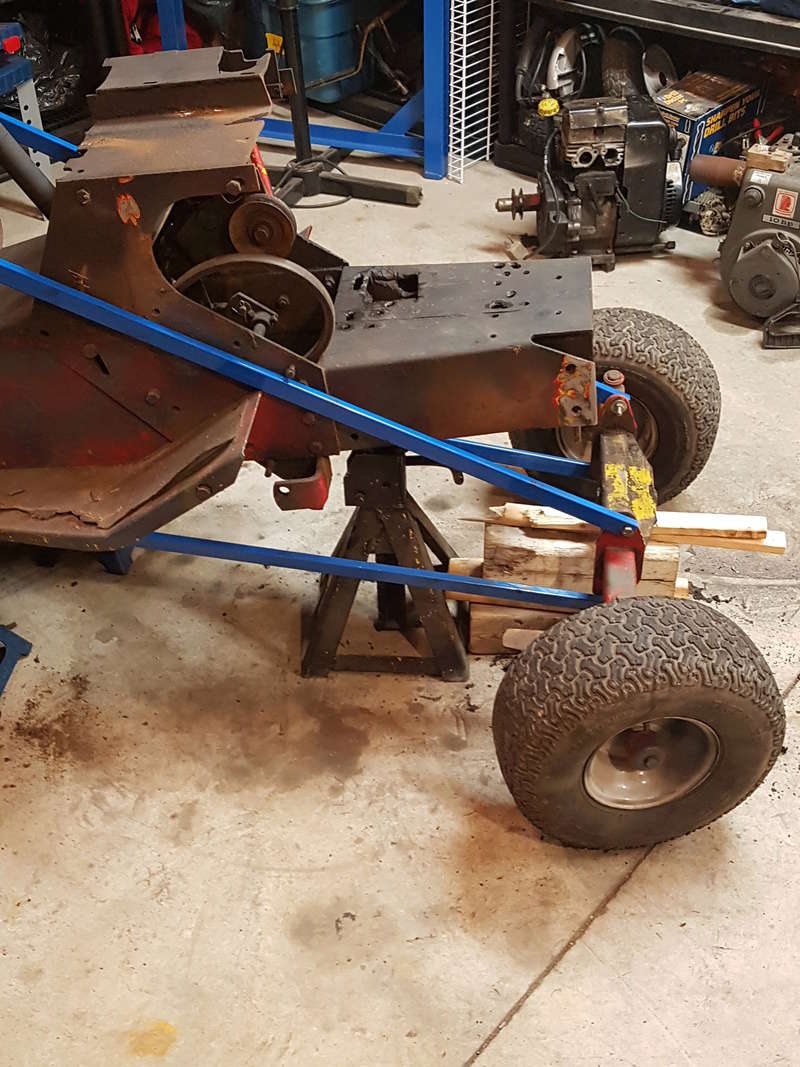

| so this what im thinking for the front,the control arms will be parallel with each other, with a track bar and coils over the front  It's a mock up i didnt want to cut anthing yet. or move the front axle back underneath and cut the frame and extend it 8-10"  | |
 | Subject: Re: 74 Franken Sears March 20th 2018, 8:24 pm | |
| Ooh! going for a parallel 4-link I see! Nice! Are you gonna put wrists in the link bars? Without joints on the end there won't be any flex. _______________________________________________ "This'll either wake you up or put you to sleep forever!"- Red Green "Whatever you do you should do right, even if it's something wrong." - Hank Hill - MTD Off-Road Build - Ford LT 110 Off-Road Build - Craftsman GT 6000 Off-Road Build - Sears LT11 Rat Rod Build *2019 Build-Off Winner!* - Allis B-110 x2, 710 & 716 - Wheel Horse 655, 953 & 500 Special - Case 444 - Bolens Versamatic & 1668 - Cub 106 & 124 - Ford LGT 125 & 145 - White 1650 Yard Boss | |
Age : 33 Join date : 2017-10-30 Posts : 2427 Location : Rochester, New York
 | Subject: Re: 74 Franken Sears March 20th 2018, 8:32 pm | |
| You could still use those mounting tabs on the Sears axle and put in some heim joints or rod ends. I like the mock up you have started here. | |

| @AllisKidD21 oh i see what your saying yes there will be, this is just ideas, @ Crazy_Carl yes that's the plan so far for the mounts and joints

 | Subject: Re: 74 Franken Sears March 20th 2018, 8:38 pm | |
| Having it in front of the frame would allow for more travel I would think, kind of like a rock bouncer. Would look pretty cool! | |

 | Subject: Re: 74 Franken Sears March 20th 2018, 8:44 pm | |
| - CraftsmanQuad19 wrote:
- Having it in front of the frame would allow for more travel I would think, kind of like a rock bouncer. Would look pretty cool!
Yes exactly, it would be better i think, i dont really want to move the engine forword. but then again I wouldn't be hitting things that hard to utilize all that travel it would be the look cool factor . | |
