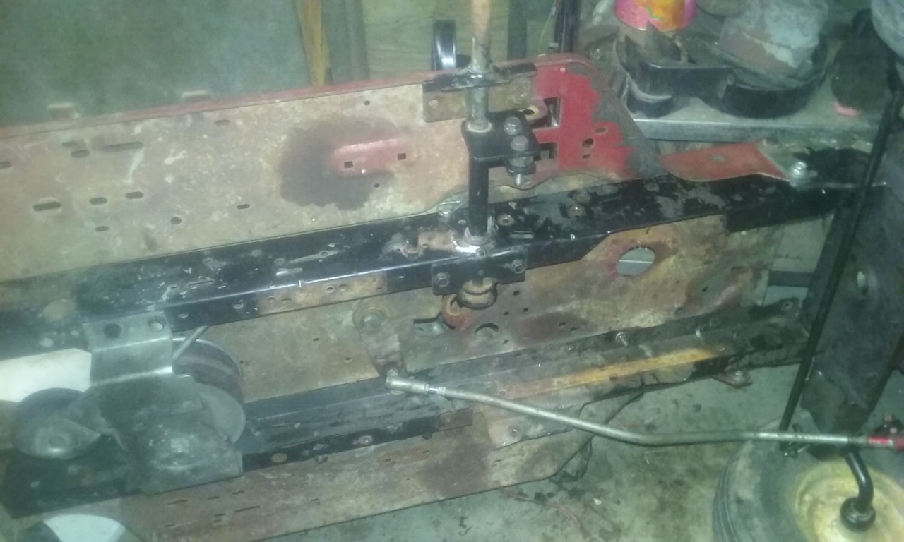

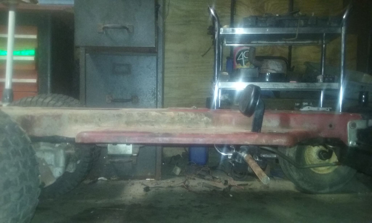

took care of the clutch and the problem with the drag link hitting with one solution, cut the bar that crossed the chassis and reversed it slid the clutch pedal assembly back on and spaced the clutch pedal a little further in so I don't have to cut the floor to operate it, I get full throw on the clutch and i'm happy with how this simple solution took care of both my problems,
my mower projects(name changed) - Page 2 43672035_519549118528506_83060501386362880_n
I still need to cut off the excess length off the bar for the clutch, and mount the outer bracket, but I will need some cut off wheels and spacers for that, next up is extending the drag link and mounting the noma pan permanently to the murray frame.
my mower projects(name changed) - Page 2 43604392_2112415092353079_3271782326610165760_n

got board and went to the garage again, straightened out the drag link, literally, it's now long enough to work and still doesn't hit anywhere, i'll still get a threaded coupler, or make the worn out rod end into one, and lengthen it because the rod ends are a lot further out on the threads than I want them to be, but they both need replaced anyway and it's good enough for now to test when I get it fully together, I have about 6 turns on each before they come off, i also mounted the pan permanently to the murray frame, I decided the millimeters that i'm off on each side are close enough for me and other than cutting out a section in the rear to fit the murray shifter it's ready for the rest of the body to go back on, I may toss it on anyway just to get an idea of how it's going to look when I get it finished, then comes phase 2 of the build, getting it ready to be converted to a 4x6, I have decided to go with stock sized tires so i'll be buying 4 20x8.50x8 knobby tires for the rear and running stock sized tires on the front, though I will have to get some aggressive tires that will bite when I want to turn on dirt.

Sounds like your drag link is going into your rod ends only about 1/4" if they are 5/16-24.  That's not enough.  Do you have a welder?
I like the idea of going to an 820 with 1" axles and 5 lug rims.  Yes this will add some cost but if you hunt around for certain parts like sprockets and 5 lug hubs for 1" shaft you can save some money.  The end result will be a stronger 4x6 with bigger tires!

yeah it's not safe as is, but it's good enough to move around, I do have a welder but it's acting up, it won't feed wire, I know it's not the motor, so it has to be the trigger or circuit board, the 820 has tires and wheels on it, they're slide on not hubed, the other set is a 4 lug bolt on, but the hubs are splined not keyed so I can't use them, wish I could and save me about $50 for a new set of hubs, but i'm going to do something fun for now with rusty, once I get the steering straightened out so it's safe, until I get the hubs, axle, sprockets, chain, and bearings i'll need for the 4x6 conversion i'm going to use the 2 tires I plan to use on the 3rd axle and make it a dually, unfortunately i'm not doing anything for the next few days due to a problem with my left foot and a matter of it being in severe pain, which is really annoying because I've been feeling pretty good lately and planned on stripping down the murray gt the 820 currently resides in and mounting it under rusty, oh well, it'll wait till my foot gets better in a few days and I can get back to work on the build
