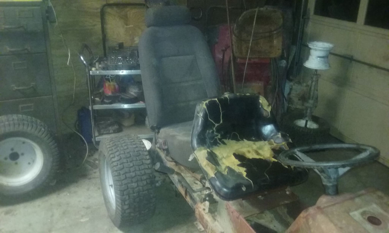

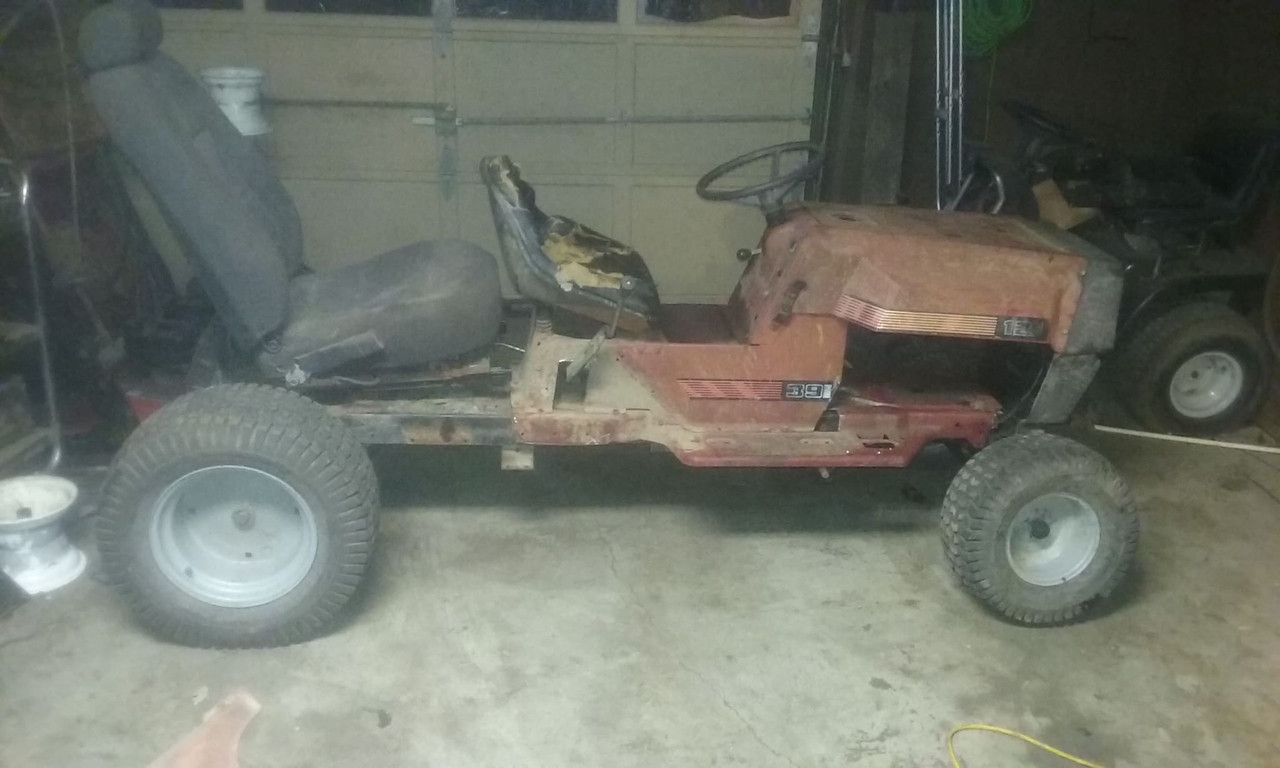

| - RockeyDA wrote:
- what are you doing with the extra space on the frame? pulling off being able to seat 2 wold be cool.
like this?   the frame and body are 99% complete, only the hood mounts are left, made a shifter rod out of a brake rod off a craftsman, has full gears forward and reverse, the wiring, engine, and drive system are still to be done and the mounting of the bed, but the bed can wait for awhile | |

| well, youd denfently want some fenders with a setup like that, so the passanger aint getting there legs ripped between 2 sets of wheels. but yeah, i think that wold be pretty cool. if you made it a car seat make you can make it quick to take on and off, so its cargo one mint and person the next. | |

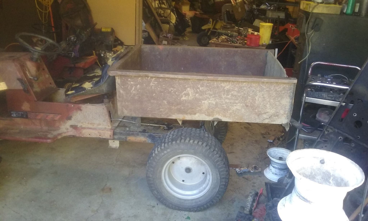

| well the bad news is I can't quite get the bed put exactly where I want it, unless I remove the seat and don't have anywhere to sit, the good news is the hitch mount plate will make a perfect place to mount a pivot for a dump feature  | |

| - darkside0914 wrote:
- well the bad news is I can't quite get the bed put exactly where I want it, unless I remove the seat and don't have anywhere to sit, the good news is the hitch mount plate will make a perfect place to mount a pivot for a dump feature
 cool start on the project, I had all the same problems with the seat and the bed, you probably saw what I did in the build off thread if not check it out. I would just scoot the bed back a little further, and I think you need some support framework for the bed, not exactly sure your plans. | |

| You have some other options to deal with this problem.
1) cut and shorten the dump bed (lots of fab time)
2) make a custom 2 piece seat, the bottom is bolted right in front of the bed and the back of the seat is actually bolted to the front of the bed, how about that for a space saving design. This way you can keep the bed where it is in the pictures but still have room to sit.
3) make a custom bed to you specifications (can be done for cheap with bed frames and plywood) | |

| I was thinking about trying the custom seat idea, @Crazy_Carl i can cut the seat down and wrap a 2x6 with foam and vinyl for a seat back mounted to the bed, for the front support on the bed itself i plan to get rid of the original support from the trailer and mount a 4x6 or 6x6 block transversely and secure that to the frame with 6-4in lag bolts, i'll have to notch it for the shifter rod, i haven't been able to work on it the last few days, due to having to replace 80% of my sewer line where the old clay pipe collapsed , but that's done so i hope to get the engine on it and take it for a test drive this weekend, i also need to make the front axle solidly mounted, i have no give up and down, but the murray gt section of the frame flexes when i step on the foot boards, i think a combo of putting in some bracing and taking the movement out of the front axle should get rid of most of that flex | |

| engine is mounted, belts are run, clutch is almost working, just need to cut a plate and extend the pedal out to where it belongs, still need to put on the carb, attach the throttle cable and fuel line and I can try a 1st test drive soon, i'll try to get actual video of that when it happens | |

| and it's alive, finished getting the engine installed and running today, set it up on jack stands and it drives with the tires in the air, still can't test the clutch though, I need to get some cutoff wheels to cut the plate I need, but I am going to take it on it's 1st test drive tomorrow, I did run into a problem though, I was putting the muffler on and the bolt snapped off in the hole, which I found odd since I had barely tightened it up when it happened | |
