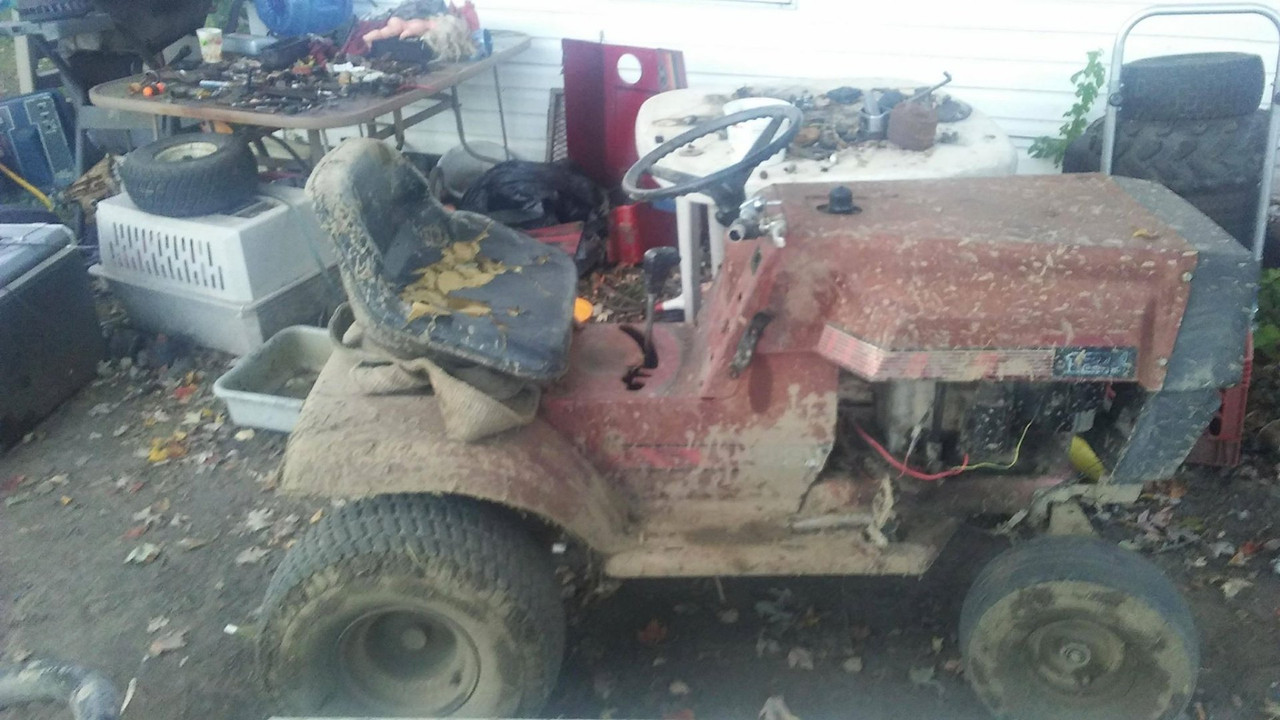

I don't know if this actually deserves it's own thread or not, it's nothing special, or really a cool build like a lot of the others, but lets see how it goes, i'll try and get pics as I go but right now it's just in the early stages of the build, and we've all seen a stripped down mower chassis.
my plan is to take my old noma/dynamark mud mower and set it down on my murray lt frame, this is the noma body i'll be using for this build
my mower projects(name changed) 22712721_639132149810057_823436927_o
the frame is coming out of my murray lt, which sadly has more issues than I want to deal with and I just like the looks of the noma better,
My plan is to completely strip the noma's underside, sort of like a going out of business sale, everything must go, if I can't unbolt it i'll cut it off, now I've had several ideas on what I wanted to do with this, originally I planned to just use the hi/low transaxle out of my brothers old yard machine gt directly driven off the engine, I did a test run with that transaxle on the noma and I got passed by a snail it's so slow, but it could probably pull a bus with ease, it was originally designed to use a veri-drive, so I started thinking, I have 2 murray LTs my old one that has a busted dash and is now stripped to the frame, but it had a mst205 originally, and my new LT widebody which had a mst202 and veri-drive, I swapped out the 202 for the 205, but the one thing I love about a murray chassis is everything unbolts and can easily be swapped into another murray chassis, so I decided to swap out the veri-drive on my widebody for the clutch setup under my old murray and use the veri-drive with the hi/low transaxle going into the noma build, this is not the end of it, once I get the noma on the murray frame I plan to use it to build my 4x6 mud /utility mower later on, my brother pulled a full size van with his yard machine before serious steering issues made us decide to just scrap it so I shouldn't have any trouble with it pulling an extra set of wheels as a 4x6

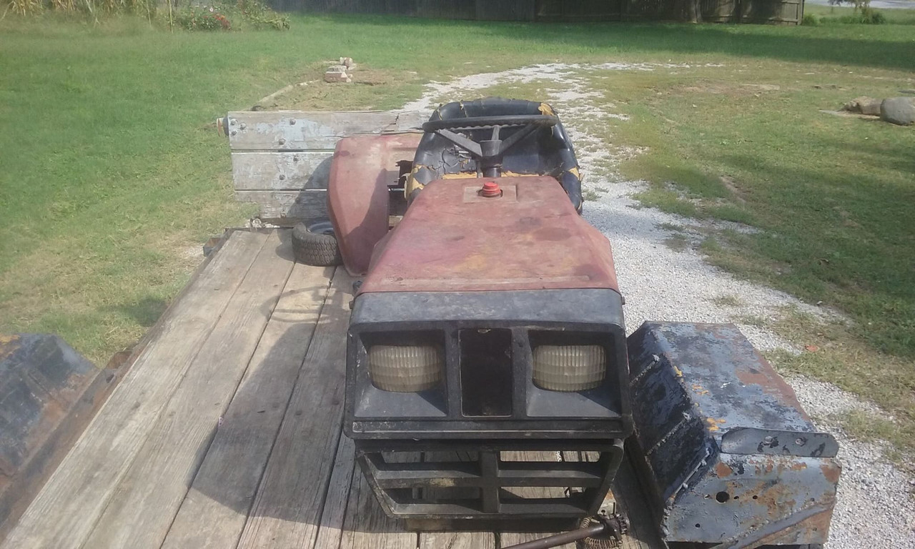

here we go, finally got some pics to post, not much progress but a little.
my mower projects(name changed) 43228430_2191894824421105_7079750157159366656_n
my mower projects(name changed) 43277912_289570815103103_3659649402793885696_n
as you can see by this pic i'm going to have to cut the noma pan to fit the longer murray frame
my mower projects(name changed) 43070618_666469060401393_2811827943804764160_n
