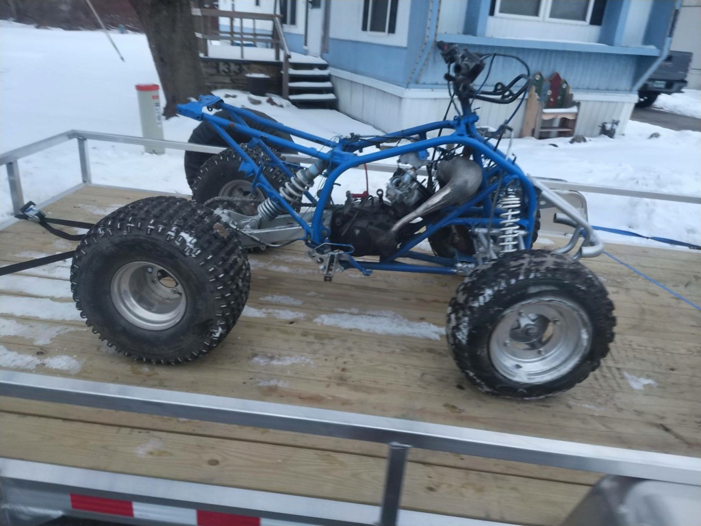

| I am planing on using the trans-axle as a pivot point for the separate rear axle connected by a swing arm. Where the wheels are sitting is about where they will end up being mounted. The front will be A-arms. I just picked this blaster up yesterday, took the picture right before I left the sellers place. I am probably going to use it for parts if I determine its not worth restoring. There is a lot wrong with it and the whole bottom half is full of water, currently one solid chunk of ice inside it. Having this will make this build much easier. I still have to make custom hubs, the wheels I have came off an UTV and I cant find hubs that will fit them that don't cost $200 a piece.  | |
