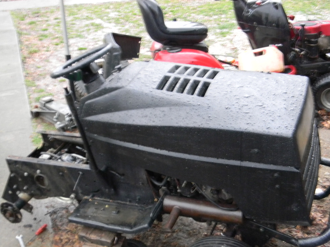

| i got the transaxle swapped over in the wizard gt still a couple of minor things need to be done before it's fully together, had an issue with one of the mounting bolts, the front bolt on the right side broke off inside the case but the other 5 are fine so they should hold it, this tractor won't be used for anything extreme, i need to get the h/l shifter, brake rod and tires mounted then it'll be ready to go again, and it's been painted, we were going to go with olive drab, but my brother was given 2 cans of satin black so he went with that instead, still might do a camo paint job on it later on, the 633 that came out of is going to be pulled apart and provided i can get the hub off, fixed and set aside for something else or kept as a spare should we actually ever need it | |

|  | | Rustbucket Garage Core Member
Join date : 2021-01-15 Points : 1972 Posts : 1070 Location : Upstate New York
 | Subject: Re: yard pro gt March 10th 2021, 8:59 pm | |
| I’d try the chains first. Linkages would be hard to fabricate in my mind. Got any pics of the new paint job? | |

 | Subject: Re: yard pro gt March 11th 2021, 5:31 pm | |
| it's been raining so i haven't put the fenders back on, it was easier to pull the fenders to get the H/L shifter and brake rod on  if i don't have the clearance to run a chain drive to a 2nd axle i have mostly figured out how to run the 2nd 633a, the H/L shifter would be easy to do, just extend the shifter back to the 2nd transaxle, the belt would be sort of easy, i would have to weld a second pulley to each and run a belt between them, it's the main gear shift that would be a pain, because it not only goes f/b but side to side, front to back wouldn't be an issue, neither would side to side, but doing both would be a headache | |
