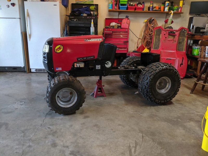

Got the engine plate welded down, welded a cross brace in the middle.  Upgraded all the pulleys for 5/8 belt.  Started the front end extension.  Repainted hood and lower part of the steering tower.
End of the day image...  Doesn't look like much.

Holy frame extension! I didn’t realize you were bringing it out that far

Optical illusion because the frame is so narrow.  Got to remember the axle is in front of the existing frame in the picture.  Then the hood mount is about another 6 inches forward.  That is going to leave about 8-9 inches left for making a bumper Etc.  Also, I do plan on moving the front axle forward about 4 inches from stock.

Exactly my thoughts. When I first saw it I think I said "Whoa" out loud. lol!.
But now that I think about it, I guess you would need that much more to do what you're gonna do.

LOL, as I mentioned, It is just the natural fish-eye some camers's do.

Didn't work on the frame any. Although I took this pic for those surprised by the frame extension at this point. I sat the grill on it at it's approximate location. See, not as long as it appeared.
-= Li'l Red =- - Page 2 Img_2132

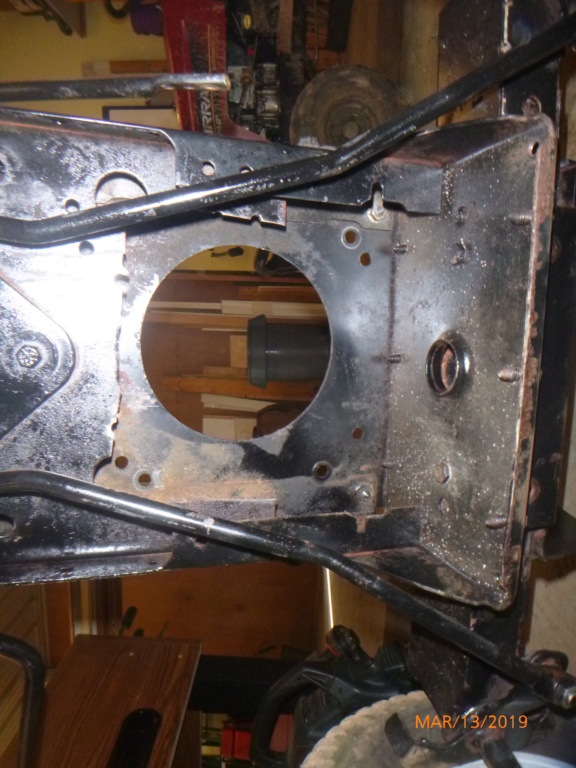

I decided to go ahead with reinstalling the shifter brackets.  In an effort to remove as many self tapping bolts, I have been changing them out with grade 8 bolts with lock washers and nuts.  I didn't want to run the bolts from the top down, as I have to remove this brace should a new 5/8 belt need changed with the 820 in there.
So...
I mounted the bolt as a stud for the brackets. (Found out the frame was a little bent doing this.  Opportunity for some straightening)
-= Li'l Red =- - Page 2 Img_2135
Installed.  I am on the fence changing the transaxle mount self tappers.  They have not been taken out ever and they are pretty stuck in there.  One of the front mounts broke.  As for the corner self tappers behind the rear plate are just there.  Those corners are welded solid.
-= Li'l Red =- - Page 2 Img_2134

I bought about 30 nuts, lock washers and bolts from Lowe's awhile back, gonna be replacing all the MM's.
As for your transaxle mounts, I'd probably just do a quick weld on the backside of the bolts. Nothing much, just enough so that if you ever have to remove the brackets, you can cut the heads off and replace them with the nuts. If they're really in there, I don't think they'd go anywhere. My brothers front end is solid and he beat the crap out of it as you saw.

There's 6 bolts that hold the 2 plates together, 3 for each transaxle bracket, and I think 6 for the bottom rear plate, but you said you welded one of those on. I'd also replace them 2 bolts that hold you body on in the rear, that is, if you weren't already planning on it.

I didn't change out the decorative back cover (seat mount back plate) tapping bolts, and do not plan on it.   I did change the two out the back with nuts.  As for the back plate with the hitch and connects to the rails, that is welded on to the 2 frame rails. I am considering and probably will change out the 3 on the trans mount on each side.  I had already changed out the ones going through the trans.

Here we go...
Green has been replaced
Blue no longer serves a structural role as that part of frame was welded together.
Yellow, not concerned at this time.
Red, I do plan on changing, but currently afraid the bolts may snap as they have never been backed out.  Don't think I will weld that bracket on, just bolt change.
-= Li'l Red =- - Page 2 Img_2136
Man that is a lot of bolts for the back foot of the frame.  I don't even have them all X'd!

All those bolts probably explains a lot of the flex. Should be pretty solid when you’re done

Heh, when I went to buy the bolts for the MM, I was like, "Eh, no big deal, shouldn't need more than 15...", Here I am now with 30, LOL.
I'm gonna bolt the hitch plate on, that way if I need to access the trans I can, but I'm gonna weld my top half to the bottom half so I can eliminate those 6 bolts.
