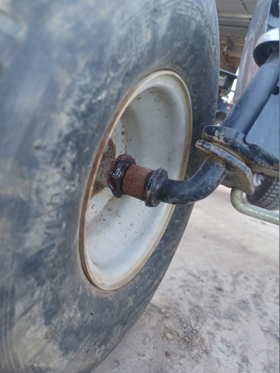

Also made some front wheel spacers to keep the wheels in place.

Things to come soon are I need to get front wheel bushings for it as these rims are missing them.

As for the front wheel bushings... if you have the crappy MTD wheels that have a bore around 7/8" your best best is to find a set with 1-3/8" bore so you can pop bearings in which you can get off Amazon for about $20 for a 10 pack.
