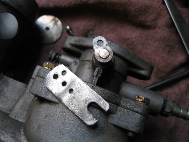

Made an extention for the throttle arm on the carb.
BAJA SEARS BUILD - Page 6 Img_3345
Welded it on without ruining anything. Just remember to remove the throttle shaft from the carb to weld it if your going to do something like this, especially if the float bowl still has gas in it. I drilled some various holes for adjusting sensitivity of the throttle pedal. Off center hole is for a return spring.

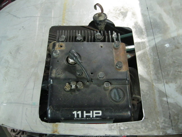

Made hood pins for front and back. Tough to get things lined up with everything off. Got it pretty close.
BAJA SEARS BUILD - Page 6 Img_3437
The spacing turned out fairly close around the engine. I might leave the hood bare, not sure yet. The skid plate will stay bare aluminum.
