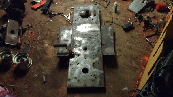

| Frame looks bare. Floorboards arent separate? I wouldve thought they were. Looking good by all means though. Im yet to start my build, need to finish the pulley swap on my craftsman, so i can get it out of the way lol. | |

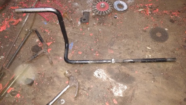

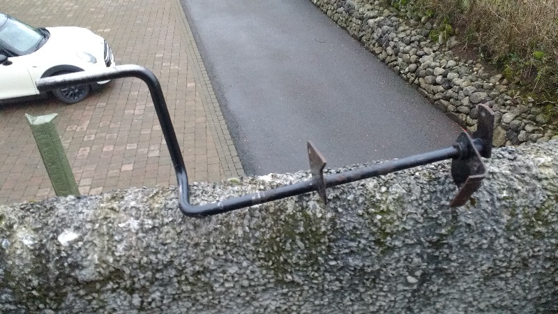

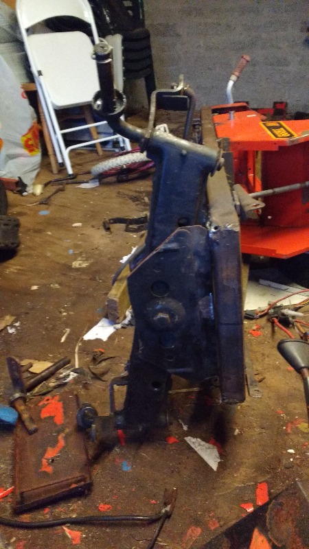

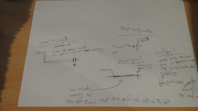

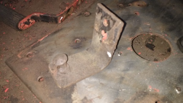

| @Jon, I'm going to keep them combined, at least for now. The way that i am going to move the pedal is relatively simple. I am just going to make a bit and of steel that mimicks the bottom half of the clutch pedal. Then make a bracket at the left side of the mower and run the rod and clutch pedal setup to it. It will be clearer ( hopefully) when I get it fabbed up and show some pics of it. Here's the clutch/brake/rod assembly that I am going to use. It's from a 1998 Rally 12hp (my first mower) @Rockinator, no the foot plates are welded onto the frame. Beginning to work out how to post pics on this phone. Takes a lot of time to do it though. Here is the front axle that I'll probably be modding to fit. I have a spare Westwood axle beam laying around and the new front axle is about one inch shorter. Edit... Made a wee drawing so that you could see what I mean

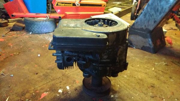

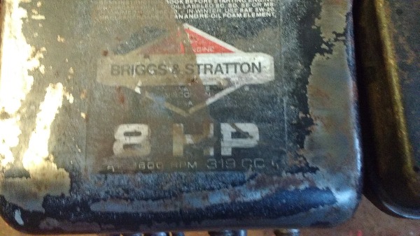

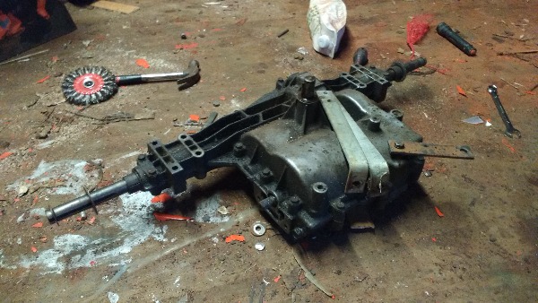

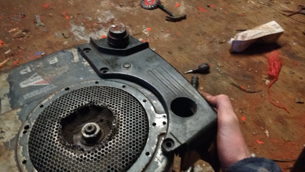

| Yeah. Should look better when I get a drop of primer on it Here are some pics of the bits that I'm gonna use for this build. Engine, 8hp briggs Transmission, peerless mst 205 Fuel tank will go about here. Just gottae fab up a bracket of some sort. | |

| Thanks. It was off a Tecumseh 3.5hp out of a push mower. I hope it's big enough, I dont Could you post some pics of that 8hp? Would be nice to see. Engine and tank will probably end up being matt white. | |

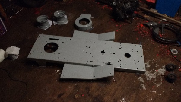

| Yeah haha its brave heavy stuff. I got the top side of the frame done with undercoat. Front rims are now fully primed and will likely get their coat of matt black today or the morrow. Engine also got a coat of matt black. Been slowly working on the clutch and front axle/steering this weekend. I got all the rest of the brackets cut off the clutch arm and got the clutch pedal and assembly out of the frame. Now just need to do some drilling, cutting and welding to make it work. And for the front axle I am now going to use a Westwood one. Just gotta fab up a steering arm, some spacers for the top of the spindles and the linkage that runs from the two spindles to connect them. Will get pics up soon | |

| Pics of this weekends progress... Paint for engine block, shroud and rims. Frame rubbed down. Stuff I used to strip back the paint and rust. Undercoat. Frame has been flipped over since this pic and the underside done and the block has been painted. Will get a pic of it today sometime. Still waiting on the frame, the rims and the shroud to dry. It's so cold!! Also when I was taking the clutch off, I managed to break the clutch spring. And for today I hope to get the rims sprayed black (if they've dried) and get the front axle finished and primed and also some work on the clutch. And maybe some engine work for too. | |

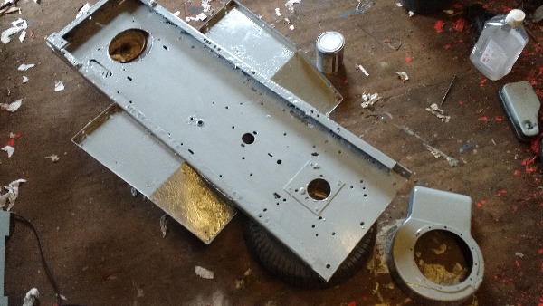

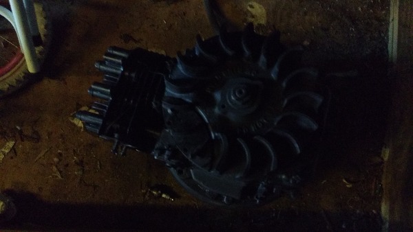

| Subject: Re: MatthewD's Westwood S1200 Build [2016 Build-Off Entry] February 18th 2016, 7:05 pm | |
| Anyway, here's the underside of the frame done. Shroud is gonna get a coat of white paint tomorrow hopefully. And here's the block painted. Sorry for the dark pic, I'll get a better one tomorrow. Pity about the rims tbh. Now it's back to square one | |
