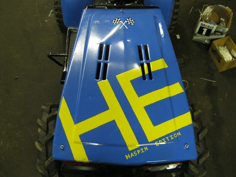

| Subject: Re: [Complete] Mr.Modified's Craftsman HE [2018 Build-Off Entry] May 30th 2018, 10:15 am | |
| Thanks. The hood is painted blue also, same color, with some big HE graphics painted on. I put some number 78 stickers on, same number as the baja sears had. The tire tread I cut by heating up a sharp scraper that I had and then carefully slicing off the knobs. It's a bit of a pain but not horrible. Just have to be careful not go go too deep by accident. | |

| Subject: Re: [Complete] Mr.Modified's Craftsman HE [2018 Build-Off Entry] June 2nd 2018, 10:50 pm | |
| Looks great mr.mod! Shoulda posted a picture of the cool hood graphic though, haha. "This'll either wake you up or put you to sleep forever!"- Red Green "Whatever you do you should do right, even if it's something wrong." - Hank Hill - MTD Off-Road Build - Ford LT 110 Off-Road Build - Craftsman GT 6000 Off-Road Build - Sears LT11 Rat Rod Build *2019 Build-Off Winner!* Garden Tractor Collection: Allis B-110 x2, 710, 716, & 410 - Wheel Horse 655, 953 & 500 Special - Case 444 - Bolens Versamatic, G10 & 1668 Diesel Swapped - Cub 106, 124 & 1000/149 Frankentractor - Ford 120, LGT 125 & 145 - White 1650 Yard Boss - Moto Mower 710-100 | |

| Subject: Re: [Complete] Mr.Modified's Craftsman HE [2018 Build-Off Entry] June 2nd 2018, 11:45 pm | |
| The tires take awhile but not that bad really once you get doing it. And it helps if you keep the tool warmed up. Had it good and sharp and then I heat it up some with the propane torch before carefully slicing off the tread.
The hood paint I didn't want to show until it gets to haspin. Super top secret lol.

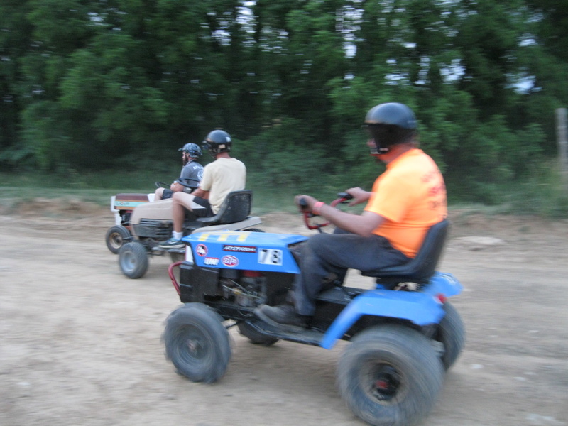

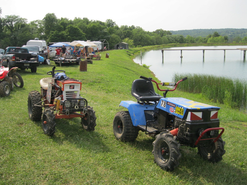

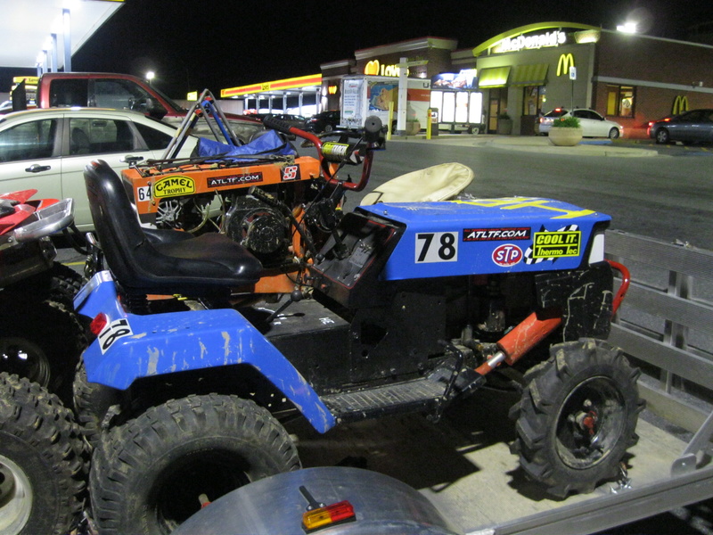

| Subject: Re: [Complete] Mr.Modified's Craftsman HE [2018 Build-Off Entry] June 10th 2018, 1:55 am | |
| The craftsman HE survived Haspin! It didn't see a whole lot of miles while it was there but it did some trail riding and my dad and I both jumped over some logs and stuff with it. I think it's a bit stiff with the solid front end but my dad didn't seem to mind it. Towards the end we had some starting issues where the starter wouldn't turn it enough to start it. I'm thinking maybe a combination of valve adjustment messing with the compression release and maybe the battery getting low from a possible charging issue. But all in all it worked out well enough that we didn't have any major issues or broken parts. The clutch is jumpy but that may improve as the belt wears in. More testing is needed for sure. Pre Haspin pic of the Top Secret hood paint... HE with the adventure edition and craftsmanquad exploring the river area My dad piloted the HE for most of the running it did at Haspin although I tried it a few times. It seemed to keep up with the crowd ok. Back at base camp awaiting the next ride Better view of everyone's camp setup in the background Loaded up and on the way back from Haspin The cut turfs worked out good enough for this run although we stayed out of any deep mud with it. The transaxle leaked from the axle shafts but it held up well and shifted ok. Front end is definitely stiff although my dad said he didn't mind it. I thought it kicked the front end around a lot and it didn't seem good for handling, but the thumb throttle and steering worked decent in my opinion. I found the clutch a little jumpy but like I said earlier, that might get better once the belt wears in. I think the belt jumped off once, it could use more keepers by the transaxle pulley to prevent that. A rear bumper would be nice and maybe some tool storage space. More testing and upgrades to come. | |
