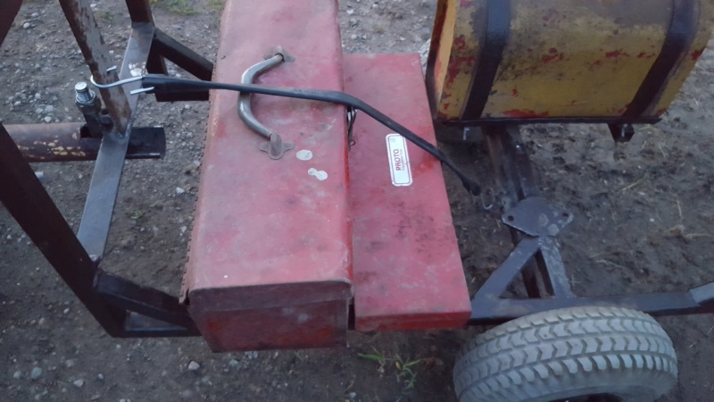

Got a couple little tool boxes laid down on there, they fit pretty darn good:
Small Off-Road Supplies Trailer 20180817
Small Off-Road Supplies Trailer 20180816
Just got a tarp strap holding them down, should be good enough.

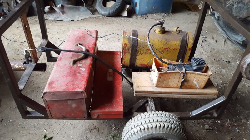

Alrighty so I got some stuff done today. I got some small clamps hooked up to the leads on the compressor:
Small Off-Road Supplies Trailer 20180822
Then for pumping out the fuel I drilled the vent hole in the fuel cap bigger and pressed in a valve stem that I cut apart.
Small Off-Road Supplies Trailer 20180823
Works good! It pumps the fuel right outta there, haha. Might take a couple seconds to fully pressurize when the tank is close to emtpy, but that's no big deal. So now I just gotta get a length of fuel line coming off the fitting to I can get the fuel into the tanks on the tractors.
I just used one of the old generator mounts to bolt the little compressor down:
Small Off-Road Supplies Trailer 20180824
Small Off-Road Supplies Trailer 20180825
Fits in there pretty good! Had the little trailer hooked up to the GT and the leads for the compressor are easily long enough to reach the battery even while the trailer is still hooked up, so that's pretty handy. Let me know what ya think!

Well as it turns out I don't ever end up bringing this little rig with me when I go out wheeling, so it hasn't seen much use other than me grabbing tools out of it.
Yesterday though I made a nice spot for it to sit inside the tractor shed, and I then decided to put the front caster back on so I could roll it around wherever I needed it.
Small Off-Road Supplies Trailer 20190846
The only other thing I did was weld onna little pocket for the end of the fuel filler hose to sit in:
Small Off-Road Supplies Trailer 20190847
Works well! It should be handy to be able to roll this little unit around the shed now.
