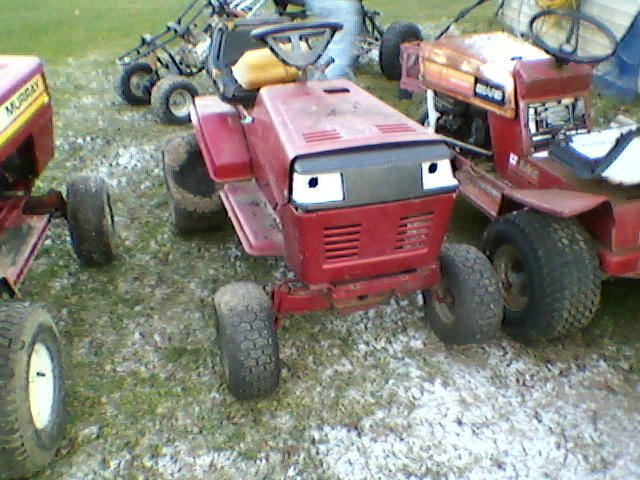

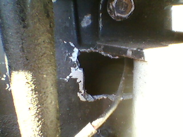

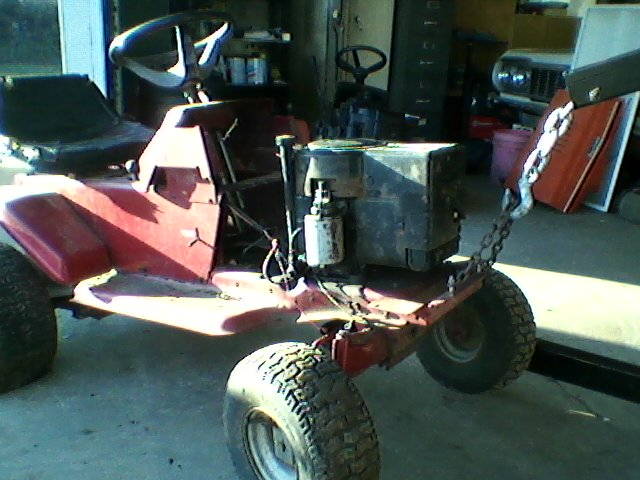

| Hey well i got another project as i started my first build the (MTD Off Road Build) wich turned out im using it for speed buggy. Well i got a 90 murray for free and it has the 1pc frame wich i like do to easy access when working on clutch,and that. The shape is poor lol seat shot the rear tires dont hold air for long, the motor has a nice hole through the side,missing some stuff no lights. I took the Engine off today and pulled my 84mtd 11hp off to put on this as this is just a mud/woods/beater. got the wiring kinda sorted out,extra junk removed,motor installed and running and i took it for a quick run in the yard. Still Tons to do!!! I need to: clean/but air filter or build a snorkel pipe -water proof coil/starter/cylinoid/switches/wires -exhaust mod -upgrade tires/wheels -front suspension -frame reinforcement -slight pulley swap -belly pan -skid plates ect winter is here and im going to just do what i can lol I want ot start video of my project and mowers, well ill keep you updated. What it first started as getting ready to pull off the 12hp As you can see why im doing this ^what happens when govern is removed and held in full throttel mode lol | |

| The PO was lucky- most times the flywheel explodes when its over revved too much . I never understood why someone would remove a governer ( risking life and limb) to gain more power , specially w/o properly building the motor up first to handle it , while itd be just cheeper to buy a larger motor in the first place. I got my 80's wizard free because the 11HP motor had the back of the block peeled back like a bananna when the counter weights carved thru it from over revving .

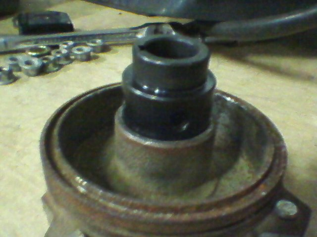

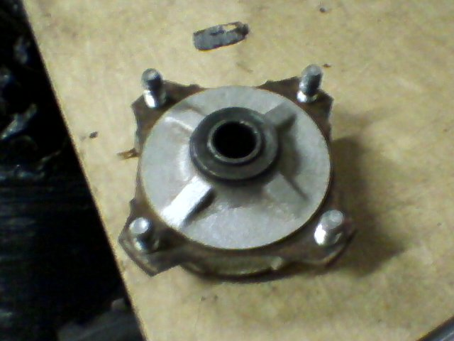

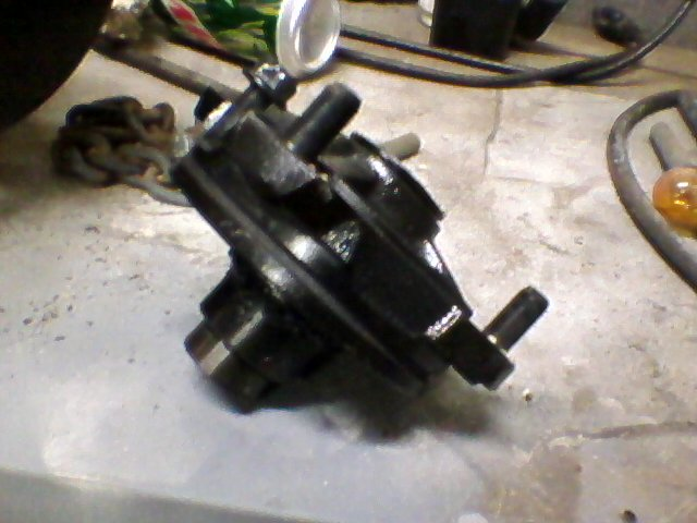

| well today i went and figured out a rear atv hub so i can run my kenda tires, well the rear hubs have the splines made in them, well it is to small to fit my 3/4 axle so i ended up taking the front hubs pulling the bearings out wich gave my lots of room to play with, found a bearing out of an old cub cadet front wheel that fit perfect and fit my axle so i put that on the outer hub and on the inside i put a chain sprocket hub it butted up nice and i lined everything up welded it and got a nice removeable hub so i can go from atv wheels to stock tractor wheels anytime. some pics stock front hub with bearing i put in sprocket hub with keyway on hub welded doesnt look stright but it is lol outer bearing in and painted and ready to go the crap part is tsc only had one hub in stock so i got to wait till 2-4 days when they get some , so i decided to put the bicycle gas pedal on and thats where im running into probs got it mounted fine but idk how to hook it to the box on the engine,mine is the old style 11hp briggs,fearlessfronts engine box is horizontal as mine is vertical like this one so any help or any suggestions would be good | |
