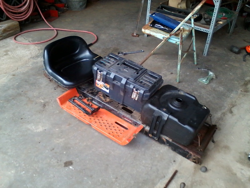

| So I had this old simplicity 6216 that was torn apart.. no engine, trans, etc. So I stripped it down to the frame today and I am going to put a gas tank off another mower on, a tool box and a seat... so I can bring friends. Pics will come shortly. | |

| Ok heres what I have so far still need an axle and a drawbar so I can hook it to the rally. Also the gas tank will have a siphon on it incase I run out of gas on long trips.   " /> | |

 | Subject: Re: Off road trailer from lawn mower frame July 11th 2013, 10:26 pm | |
| not bad so far, I get the idea... thinking if building one using the harley cart parts and whatever roll cage tubing I do not re-use on nightmare (or to build the headache rack for my truck) |

| Looks good. I thought of making my trailer have a seat to lug people around, but I just make them sit on the toolbox lol.  Head Forum Administrator ** Chat Moderator ** Facebook Page AdminATLTF Facebook Page ** Chatbox ** How To Upload Pictures

| I suppose it'd also be factored in if the balance of the trailer was off either by design or load... but I can see how it'd affect off-roading. What about building a trailer with ground clearance and an almost 0 balance factor so it could be lifted up front or rear with just a couple fingers? |

| What kind of tires should I put on it wide or narrow. I'm thinking wide cause I want it to float over the mud, water,and the mushy stuff that I would happen to drive over. Right??? | |

| Wider, and even taller, the better, bigger contact patch.
Balance is a little tricky. It's not like a road trailer for a truck, where you want 10% of the weight on the tongue.
You want to add as much weight to the tongue as possible for offroading, to put weight on the rear axle of the towing tractor, and increase traction.
But, too much, the front end of the towing tractor will push, and you won't be able to steer. | |

| Yeah I'm going to put the tires just in front of the seat should that work? | |

| You definitely want some big wide tires for flotation. The other day I was hauling my little trailer around- it has wheelbarrow tires and is used for hauling garbage to the curb- and ended up getting stuck in mud that I normally wouldn't have a problem with. Thank god for winches! | |

| - LAWN MOWER MUDDER wrote:
- Yeah I'm going to put the tires just in front of the seat should that work?
That or a hair farther forward would probably do well. Looking at your pic again I'd say (using the current arrangement in the photo) to put it just under the seat side of the tool box. Still would shift balance to the front of the trailer and the rear wheels of the tractor without giving it too much to steer properly. |
