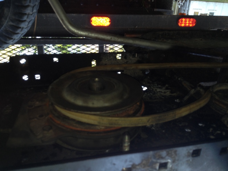

craftsman drag race mower Image12 this is the electric clutch I am running
craftsman drag race mower Image13 I'm almost done installing I have to get a spacer and bolt the wire it up. I couldn't keep the ordinal clutch on because a it was hitting.

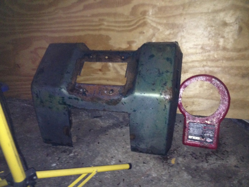

craftsman drag race mower Image17 what do u think about this color blue with matte black accents?

PostSubject: Re: craftsman drag race mower   craftsman drag race mower Icon_minitimeNovember 1st 2013, 11:29 pm
that shroud looks like it needs some serious attention
The result of paint stripper

PostSubject: Re: craftsman drag race mower   craftsman drag race mower Icon_minitimeNovember 1st 2013, 11:30 pm
 its interesting, to say the least.. i'd go a bit darker so it dont show dirt as much. i do like the general scheme though
