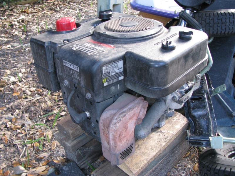

 | Subject: Re: Hot rod craftsman November 17th 2013, 7:07 am | |
| The Hot Rod got a engine, not what i had originally planned (being a twin) i couldn't find one around atm so i decided to throw on my old atv engine (Suzuki 160) the frame for that atv was done. im ditching the suspension in the back because i want to eliminate any weaker parts since i have this torqy ass engine now. still might do a inch or so suspension in the front so the aftermath of wheelies isnt very bad... will post pics soon!

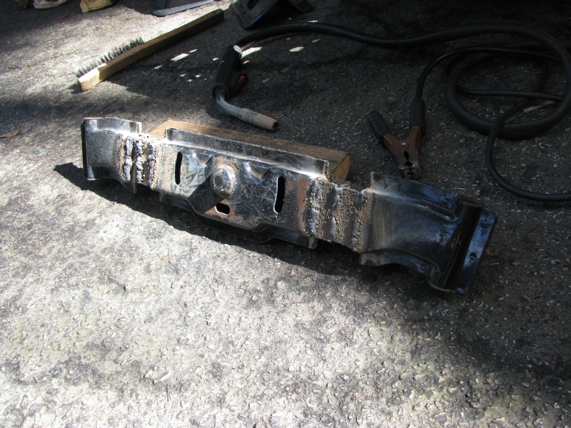

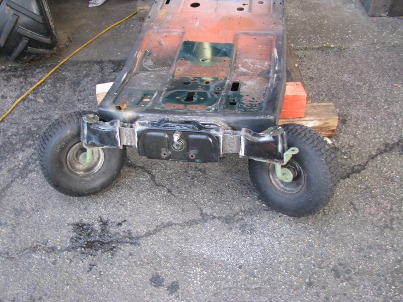

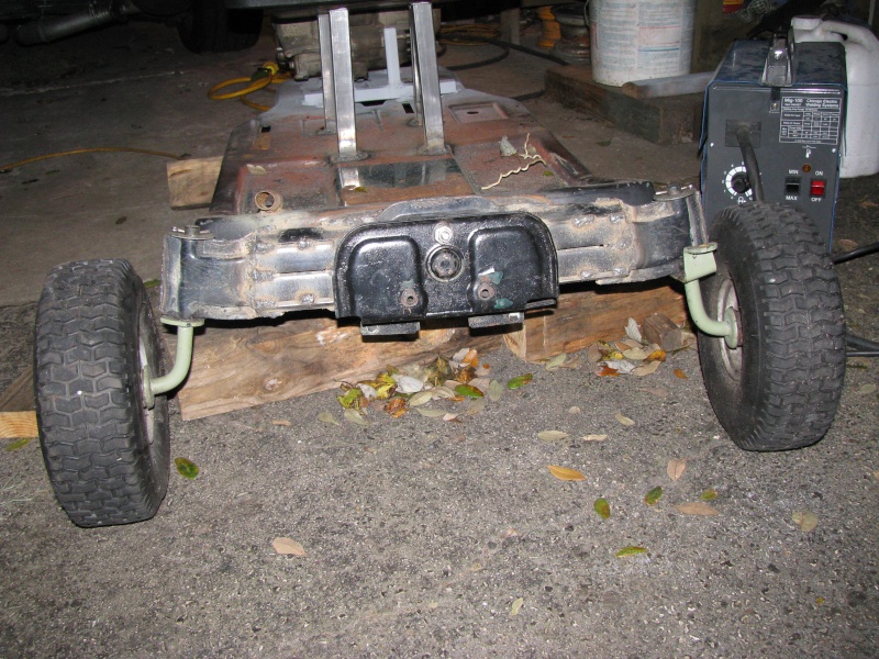

| got some pics of this thing widening the front wheel base. not finished braceing it up though  how it looks with the suzuki  the rear motor mounts (will cap them)  the front mount will connect to the seat bracket to strengthen it up some  it all tached up  it welded up solid(without the flat going accross the box steel and over lapping the original axle)  temporaliy bolted on.. (ditchin the front suspenion cuz i dont want anything extra to break lol)  pretty decent weld  side angle  | |

 | Subject: Re: Hot rod craftsman November 18th 2013, 5:12 pm | |
| Wow- you got a lot of weld in that front axle. Looks like it will do the job. I'm surprised you didn't fab up a new one. | |
GenevaCustoms Frequent Poster
Age : 25 Join date : 2013-09-24 Posts : 315 Location : Florida
 | Subject: Re: Hot rod craftsman November 18th 2013, 6:00 pm | |
| Wait till you see what I did this afternoon.... Finished bracein it up with 1/8 flat steel.... Going across the whole extended gap. Don't think it will ever break lol | |
 | Subject: Re: Hot rod craftsman November 18th 2013, 6:02 pm | |
| On the last picture u can see were I ran a quick bead down the very end price. The axle is two pinched pieces of steel so in certain spots all around it I welded a bead to make sure they won't ever separate... | |

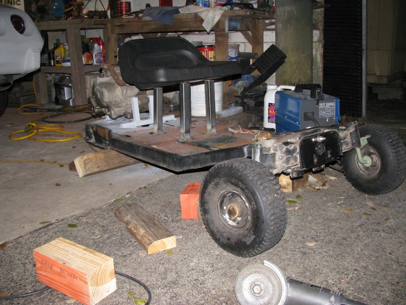

willis923 Veteran Member
Age : 25 Join date : 2013-04-10 Posts : 1408 Location : Galway NY
 | Subject: Re: Hot rod craftsman November 18th 2013, 8:24 pm | |
| i see stamped frame.. i'd re enforce it with box steel down the sides, maybe angle crossmembers. just my 2 cents _______________________________________________ -1974 bolens 1055 (Rolling Thunder) -1989 Craftsman GT6000 (Blockhead) -2004 Ford F-250 super duty FX4 -1999 Ford F-350 Superduty 4x4 7.3 Powerstroke - Lt wrote:
 | Subject: Re: Hot rod craftsman November 18th 2013, 8:28 pm | |
| Willis! I am going to run at least two pieces a box longways and three sideways. Underneath so you won't even notice it haha | |

Doc Sprocket Administrator
Age : 49 Join date : 2013-04-21 Posts : 2914 Location : Ontario Canada
 | Subject: Re: Hot rod craftsman November 19th 2013, 6:33 am | |
| I also just noticed your exhaust. Under the running board, where the pipe goes into the bull end of the tee... That restriction is not going to do your engine any favours. You might want to re-think that. | |
 | Subject: Re: Hot rod craftsman November 19th 2013, 8:07 am | |
| Doc I thought about it and ive been runnin it for while now though... Idles perfect (better actualky) and revs nice no backfirin and actually ts workin great lol | |
 | Subject: Re: Hot rod craftsman November 19th 2013, 7:46 pm | |
| finsiihed up the front end.. Beefed like crazy and the beginning of the seat mount blends into the night..  front end veiw   88 wag and 76 vett in the backround  theres the beef i was talkin bout doin... 1/4 flat steel solid as a brick now...  watch the youtube vid and tell me what you think about the gas tank idea https://www.youtube.com/watch?v=VrxiE63qr2A&feature=youtu.be | |
