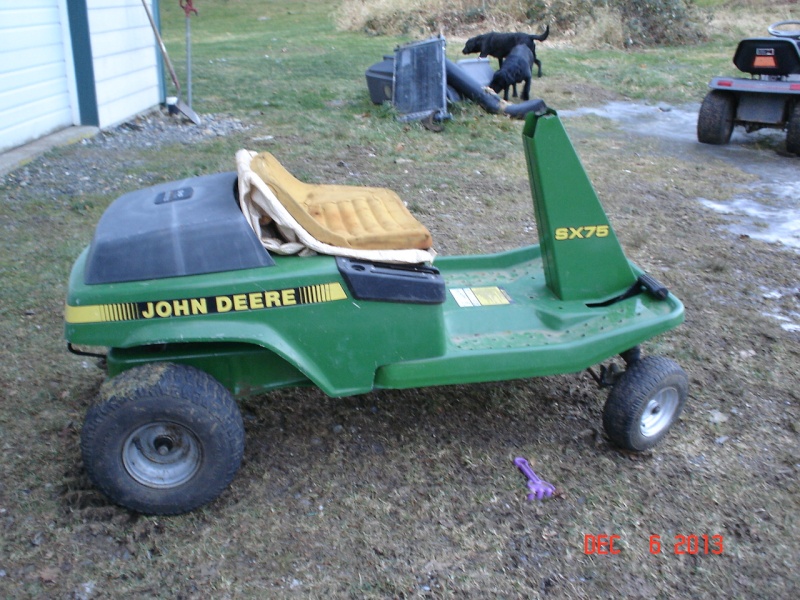

PostSubject: JD SX75 go-cart thingy   JD SX75 go-cart thingy Icon_minitimeThu Dec 05, 2013 8:25 pm
a few mock-up pics
on the operating table
JD SX75 go-cart thingy Projec33
on 4 wheels!
JD SX75 go-cart thingy Projec32

the stock holes didn't match the MTD transaxle mounts, so I made the subframe, and I got the idea.
