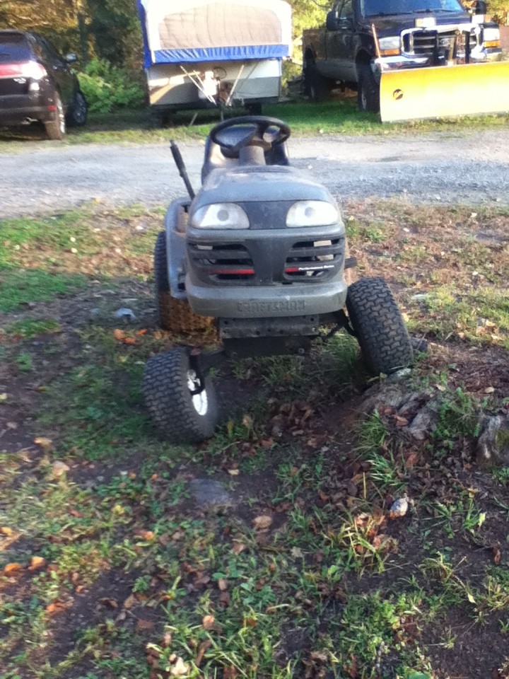

Hey I'm just posting this to see what kind of ideas i can get for my project
The mower is a early 2000's Craftsman LT2000 with a Kohler 17 hp command 1 backed by a 6 speed peerless.
List of current mods:
-pulley swap
-22" atv tires back 17" front
-exhaust with a mini quad muffler
-front end lifted to level the tractor
-full rewiring system
-front bumper made from tht same mini quad (not in picture)
-steering reinforcements
The locker is coming this spring, i want to see how it does without a locker
Feel free to comment with any ideas that wont put a hole in my wallet
thanks,
jamcco

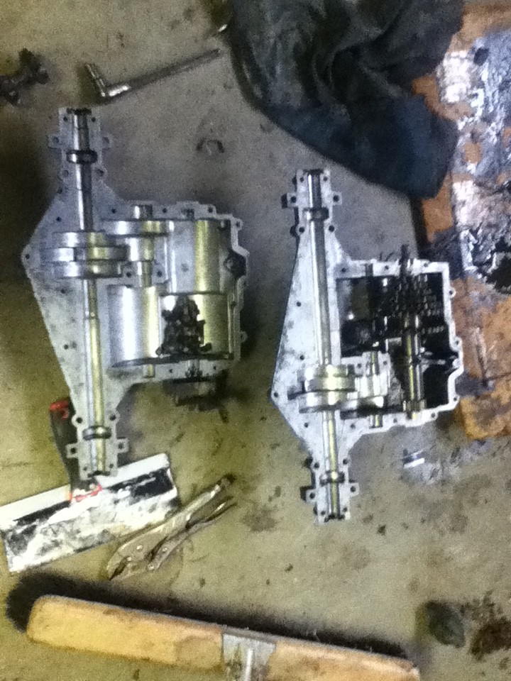

got the transaxle out today and opened it up, after looking for a bit i've decided that the fozzy wont work so well for this, i would have too much play. so I'm going with FearlessFront's method. First im going to clean out the entire transaxle and make it look like new....sorta. then put down a heavy hot bead on the spider gearsCraftsman Lt2000 Project 00110
Craftsman Lt2000 Project 00214
A peerless mst 206, soon to be locked

ok got some more work done today.....i locked the transaxle. i dont know if my welder was strong enough but theres only one real way to find out. by the way this is my first time ever opening up a transaxle, they are simpler than i thought they were.Craftsman Lt2000 Project 00111
excuse my ugly welds... im just getting into welding. also this picture was taking before i removed all my slag
Craftsman Lt2000 Project 00310
cleaned the case... it think i did pretty good for a beginner
Craftsman Lt2000 Project 00413
just some of the parts that came out of the peerless
i put the two halves together, shifted threw all the gears and spun the pulley with my hands, spins as good as it always did i just need to get some gear oil for it, seal it, bolt it back in and break it in

jamcco wrote:
richie thomas wrote:
jamcco wrote:
difs locked, its working at the moment. It's funny to be riding a mower around your snow covered field and get thumbs ups from random people driving by, they cant imagine a mower being able to do this kind of thing Cool
you should see the looks i get going down the highway with my lifted in the bed of my truck lol
i cant imagine what looks you'll get with the duece,  lol!
yea i know....ima have to borrow a trailor to move it tho, it wont fit in mine nor my dad's long bed truck
true...man that things going to be nuts when its done, i really like how its looking right now
thanks, im sposed to be getting the second tranny this friday

i hope my locker holds up, i think the next mod im going to start is getting the brakes hooked up to a hand brake sort of like fearless did. i also want to make it so the deck height lever acts as a e brake. pretty simple mod in my mind
jamcco
jamcco
Join date : 2014-01-04
Points : 3859
Posts : 226
Location : New Hampshire
Craftsman Lt2000 Project Empty
PostSubject: Re: Craftsman Lt2000 Project   Craftsman Lt2000 Project Icon_minitimeApril 6th 2014, 8:22 pm
DANG IT! ok so im driving around in the field enjoying the fact that i can go anywhere with a locked dif. I notice its getting late so i pull onto the paved road (alot smoother than a frozen field) and floored the new gas pedal i made yesterday. I need to clock the speed on this thing it is fast. but anyways i pull into the driveway....go to park it and notice only one wheel spun when i got onto the snowbank.... so at first i though "how the #$^% did this break already." then i thought "you idiot you just drove it back to the house in 6th the welds just spun off"....... so in other words i need to crack the case back open and lock it again...im going with the fozzy seeing my welder isnt strong enough for fearless's method
i need to get this thing working before mud season Shocked
