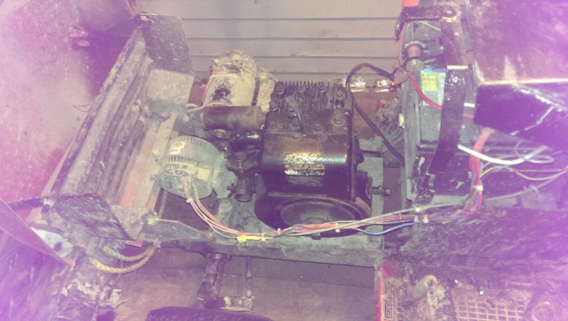

last week i got the 212cc clone off. i started to put the 8hp briggs on but i dont know what im going to do with the starter generator yet. i might ditch it and go back to pull start only...
im keeping the alternator for sure tho.
heres some pics.

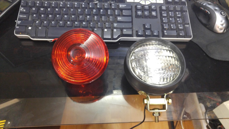

ROPER Utility\Trail Build - Page 4 20170111
i got this for the roper. im gonna put the light on the rear so i can see stuff behind me when i backup in the woods.
the brake light is gonna be a taillight.
http://gdftech.com

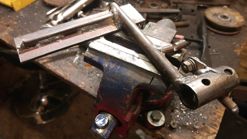

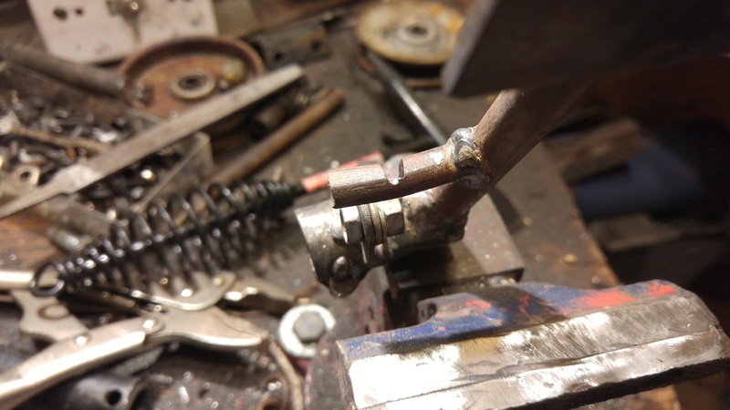

this is the part on the tractor. you can see the pedal pivot point, the hole is treaded for a 1/4in bolt to hold the pedal assembly on. theres a spring tap too out of the pic.
ROPER Utility\Trail Build - Page 4 20170117
thats my reinforced pedal with the pring tab and the wire stop braket.
ROPER Utility\Trail Build - Page 4 20170115
ROPER Utility\Trail Build - Page 4 20170112
ROPER Utility\Trail Build - Page 4 20170113
ROPER Utility\Trail Build - Page 4 20170114
ROPER Utility\Trail Build - Page 4 20170116
so the throttle pedal is done

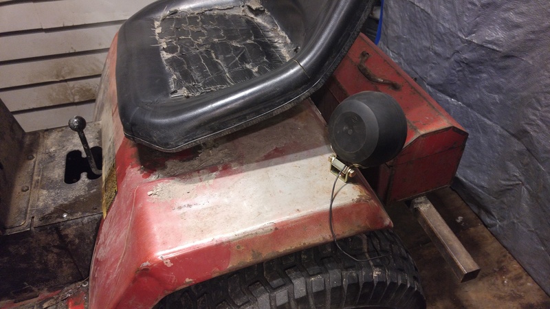

today i finished the pullstart, did the choke linkage and started to mount the rear light.
the light i just bolted up to where i want it. i still have to wire it up to its own switch on the dash.

today i mounted the gas tank, got a drive pulley, and instaled the pulleyfor the alternator. i also had to make a small idler to make the belt work for the alternator.

Looks good man! I just noticed the exhaust threads in to the block, that might make it kinda difficult to remove haha.
the muffler screws in the block but the pipes are just slipped inside of the muffler.

Oh! Ok that makes sense
