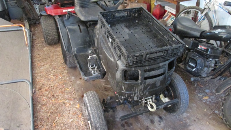

M-99 (1999 Murray)
This used to be a 1999 murray wide body, 42" 17HPIC Briggs oppy, pearless hydro. got for free from my neibors about 4 years ago. (More Or less) they were going to scrap it. Frealess front gave me the want for it and thanks to him, im in what im in now. now, it has........
DONE
MST-205
LOCKED WITH MY EZ-LOCKER! NO WELDER OR MELTING ZINK! https://www.atltf.com/t4339-lock-with-out-a-welder-or-melting-zink

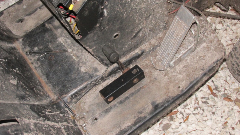

custom under-seat shifter
18 HPIC briggs oppy
1:1 pully swap, dual pully clutch, (WAS STOCK! added a idler though)
MR.gasket gas pedal
2500 traveler (TSC) winch
OH-S*** handles
custom hood mount. (The hood is NOT the orig hood)
Brakes are operated by the old gas lever
Whole re-wire. nothing will run with out the key in place, the engine will run and charge, but it can not be started
better front tires and hubs
steering stops
RE-Enforce front end (first one bent, then i totaled it by hitting a tree Shocked )
(The old 17HP oppy, i ran it out of oil, then it had a rod nock on the right cylinder, then i got the MTD, here:
https://www.atltf.com/t4330-honda-mtd-build
took the 18HP off of that, and put it on M-99.
TO DO
12 volt outlet
idiot lights
extend front bumper
rear rack?
rear receiver hitch
Brake Pedal
Exhaust header and under body style exhaust (Like Fearlessfront, but with a twin!)
MORE LIGHTS! (not like i need them)
Alternator maybe?
I THINK that's it...............
this post is for the up-to-date Working pics:

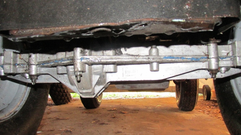

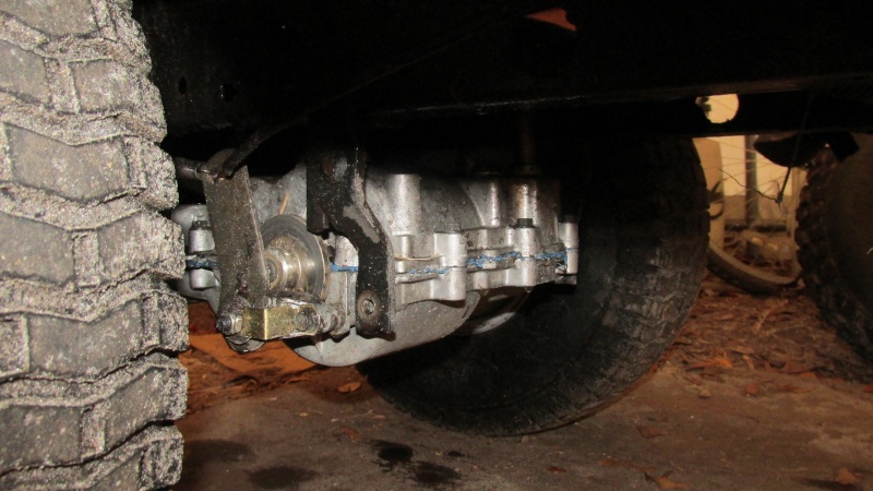

so, got the tranny and took it out, found out this thing is a submarine! i sunk it to where you saw none of the wheels! i had to winch it out once, and was able to push it out another time.

Just one, two wont sit properly (Trust me, i tried about 60 times!), and it works with the standard mst bull gear. with the rounded inside. yes, your tranny vid made me try it. so.... thanks
mudman604
Join date : 2014-12-03
Points : 3169
Posts : 110
Location : hudson FL
M-99 1999 murray wide body Empty
PostSubject: Re: M-99 1999 murray wide body   M-99 1999 murray wide body Icon_minitimeDecember 11th 2014, 7:19 am
Note: the tranny case blew because i was a dumbo and didn't put the tabbed bushings in place. not because of the locker.

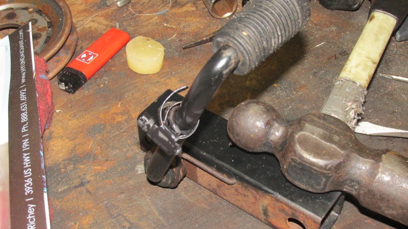

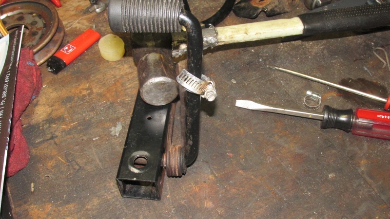

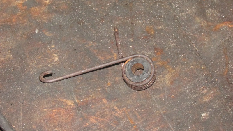

PostSubject: how to make a brake pedal from old deck parts   M-99 1999 murray wide body Icon_minitimeDecember 26th 2014, 7:48 pm

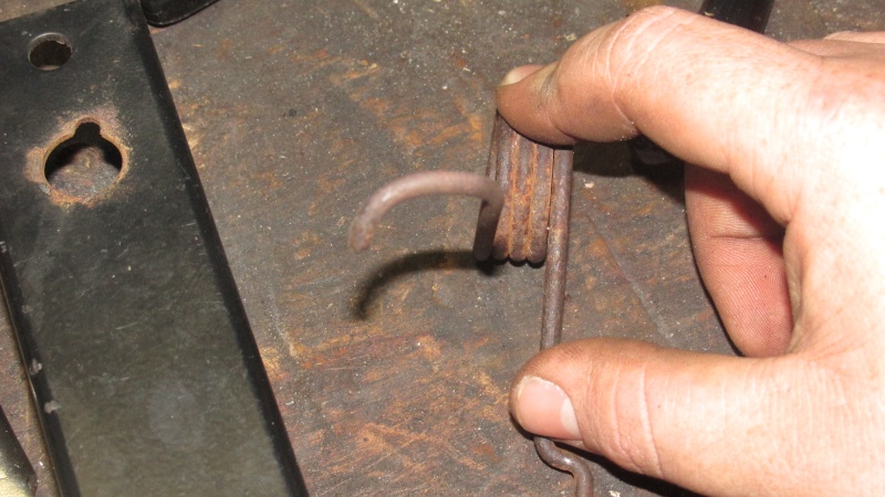

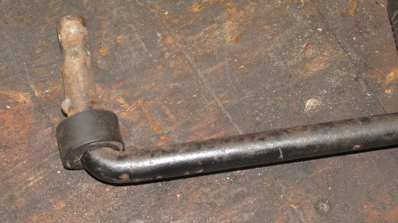

ok so im going to put on a brake pedal, i started working on it today.
parts needed:
grip (From murray deck engagement lever)
deck level hard ware 1999 and newer. (i Think)
curl spring.
M-99 1999 murray wide body Img_0610
M-99 1999 murray wide body Img_0612
cut grip about here, then put on short end.
M-99 1999 murray wide body Img_0611
this is how the pedal will be set up....
M-99 1999 murray wide body Img_0613
then take small peace of grip, and cut of rest of the ribs...
M-99 1999 murray wide body Img_0614
M-99 1999 murray wide body Img_0615
then the now spacer will fit in the spring like so....
M-99 1999 murray wide body Img_0616
now bend the hook end of spring like this....
M-99 1999 murray wide body Img_0617
then i drilled a 11/64 hole for the other end of the spring to fit in. measure/position this from the hole with the notches in it. not the hole you see here....
M-99 1999 murray wide body Img_0618
then the spacer goes here
M-99 1999 murray wide body Img_0619
then it goes together like this
M-99 1999 murray wide body Img_0620
now to keep it from springing back past the spring, put a hose clamp on it and give it some paint
M-99 1999 murray wide body Img_0621
M-99 1999 murray wide body Img_0622
it will then be mounted like this
M-99 1999 murray wide body Img_0623
and then i will have a cable going straight to the brake lever.
i should change my username to picture man lol!

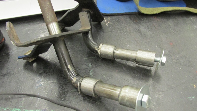

ive been modifying the stock spindles to use these hubs. the spindle is 3/4', and the hub is 1, so i got some collars(for lack of better words,) to expand the 3/4 to 1.
M-99 1999 murray wide body Img_0749
the spacers are tak welded on, i haven't done the other spindle yet
M-99 1999 murray wide body Img_0750
then i drilled and taped some 3/8 bold holes to hold on the hub
M-99 1999 murray wide body Img_0751
on one, i went 1' deep, then realize that that's two shallow, so i will cut this bolt short, the other one i went 1.5', and its perfect.
M-99 1999 murray wide body Img_0752
M-99 1999 murray wide body Img_0753
M-99 1999 murray wide body Img_0754
that's all for now, i will get pics of the hubs when  get home
