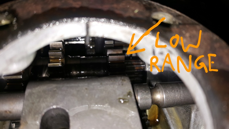

 | Subject: Re: Craftsman GT 6000 Build September 9th 2017, 10:22 am | |
| Well I took the shifter assembly out of the trans today because I'm fairly certain this is an internal problem.  I actually got it to go in low range, but I had to finesse the input gear for the ranges with a screw driver. What I've figured out is the input gear for low range is sliding on the splined shaft, so when the sliding gear for low range moves over it pushes the input gear out of the way. I managed to get some pics through the shifter hole.   In the second picture you can see once it goes in high range the little input gear slide over out of the way, meaning the low range sliding gear can't mesh with it. So I'm quite glad nothing's stripped but what could've caused this? Am I gonna have to open it up and put a spacer on the shaft? Any advice is appreciated  "This'll either wake you up or put you to sleep forever!"- Red Green "Whatever you do you should do right, even if it's something wrong." - Hank Hill - MTD Off-Road Build - Ford LT 110 Off-Road Build - Craftsman GT 6000 Off-Road Build - Sears LT11 Rat Rod Build *2019 Build-Off Winner!* - Allis B-110 x2, 710 & 716 - Wheel Horse 655, 953 & 500 Special - Case 444 - Bolens Versamatic & 1668 - Cub 106 & 124 - Ford 120, LGT 125 & 145 - White 1650 Yard Boss *I have 21 tractors and over 40 chainsaws, I need help* | |
Age : 24 Join date : 2016-07-10 Points : 7944 Posts : 5165 Location : Ontario Canada
 | Subject: Re: Craftsman GT 6000 Build September 9th 2017, 10:50 am | |
| AHA I feexed it! It turns out theres like a really strong C-clip thing that snaps on the splines on the shaft. You can barely see the tip of it in this picture  As you can see is way over to the side which is why the low range gear was sliding back and forth. All I had to do was use a prybar and a mallet to tap it back up against the low range gear, it was kinda hard to move it cuz it's pretty strong, but it works now! It goes into low range no problem! I'm glad it was nothing major and now I can put 'er all back together and see if I can get this thing running and driving. Stay tuned!  "This'll either wake you up or put you to sleep forever!"- Red Green "Whatever you do you should do right, even if it's something wrong." - Hank Hill - MTD Off-Road Build - Ford LT 110 Off-Road Build - Craftsman GT 6000 Off-Road Build - Sears LT11 Rat Rod Build *2019 Build-Off Winner!* - Allis B-110 x2, 710 & 716 - Wheel Horse 655, 953 & 500 Special - Case 444 - Bolens Versamatic & 1668 - Cub 106 & 124 - Ford 120, LGT 125 & 145 - White 1650 Yard Boss *I have 21 tractors and over 40 chainsaws, I need help* | |
Age : 47 Join date : 2016-09-06 Points : 13129 Posts : 9294 Location : Oklahoma
 | Subject: Re: Craftsman GT 6000 Build September 9th 2017, 12:15 pm | |
| That is some good information Allis. I have not see this issue with this transmission before. Good job! | |
