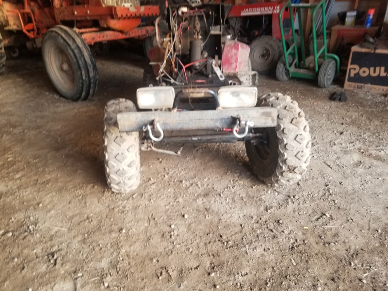

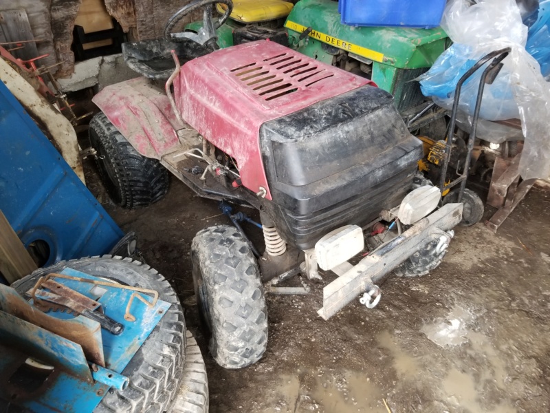

Weeeeeell I finally went and rolled the poor neglected MTD out of the shed yesterday to do some work.
MTD off-road build (Mobile Terrain Dominator) "2" - Page 18 20200241

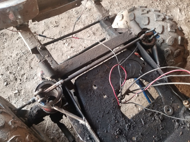

So lately I've been noticing that it sits crooked when you look at the front, like lower on the one side. Never knew what was causing it but today I finally tracked it down to the coil buckets up front. I thought about it, and decided the easiest way to fix it was to cut them off and make new ones:

After I cut the old ones off I determined where ride height was gonna be and lifted it a little above that to allow for some spring sag. Then I just sat the springs in the lower buckets and let the coils figure out where they wanted to sit.

Didn't turn out too bad, she sits level as can be now!
MTD off-road build (Mobile Terrain Dominator) "2" - Page 18 20200248

Oh I also adjusted the Y-links to tune the geometry in a bit, as it was off on the one side:
MTD off-road build (Mobile Terrain Dominator) "2" - Page 18 20200249
It's dialed it quite nicely now.
