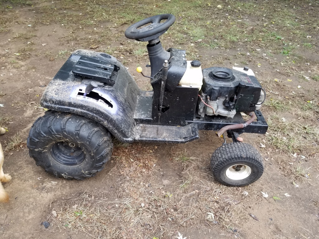

One of my recent and quick builds that I didn't 2ant contest a thread about:Talk About Anything Thread V3 - Page 24 20181012
Talk About Anything Thread V3 - Page 24 20181010
Talk About Anything Thread V3 - Page 24 20181011 did a simple and clean wiring job, 7 inch front and 5.5 inch rear pulley, double clutch, ungovenred kohler that was on my first John Deere and then the murray and now this, hits over 27mph but outbthe phone away after that as driving one handed on a muddy road was kinda sketchy.
